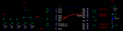

I have made up six boards and three of them had an unusually high standby current (35mA instead of 1mA).
Eventually, when the IC was removed, we found Pins 5 & 6 of the removed IC were shorted internally (0.3R)
They were also shorted to pin 45 with 3.7R. The other two boards are showing similar shorts.
The board worked fine with a new MCU.
Does anyone know what might cause this short?
TIA,
Patrick.

> STM32G070CB76
Not a chip. Probably STM32G070CBT6?
Pins shorted indicates hardware damage. Probably due to overvoltage at one point. Does L3 cause VREF+ to spike at powerup? What is attached to LED_WHITE?
Thanks, typo in chip code corrected to STM32G070CBT6.
LED_WHITE connects through a resistor to a led.
VREF+.. I don't know - some kind of intermittent event? These are the second batch of boards - the first 10 had no issues with hundreds/thousands of power-ups.
Could ESD be an issue?
Yep, it could be ESD.

ESD could always be a cause of a hardware failure, but in my experience it's typically something else. These chips aren't particularly sensitive to ESD.
Thanks TDK,
Thats good to know before I get on to the assembly house about their ESD prevention measures - they tend to be very touchy (pun intended) about that :)
I suppose I was hoping that someone from ST with an intimate knowledge of the inner workings of the IC could come back with a "This failure can only be caused by a spike on pin X" type reply.
