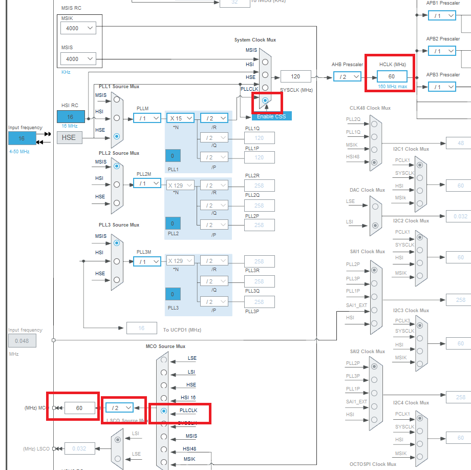

Why you didn't attach your ioc file?
@Maaz1 wrote:
This is my ioc file
No, it's just an incomplete screenshot.
You still haven't shown the MCO configuration!

I have attached my ioc file
Hi
I have attached my file here
Hi
I have attached my .ioc file here.

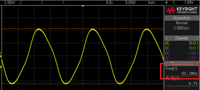

I've generated a project based on your ioc file and tested it and I can see 60Mhz on PA8 with a STM32U5G9J-DK2 board:
