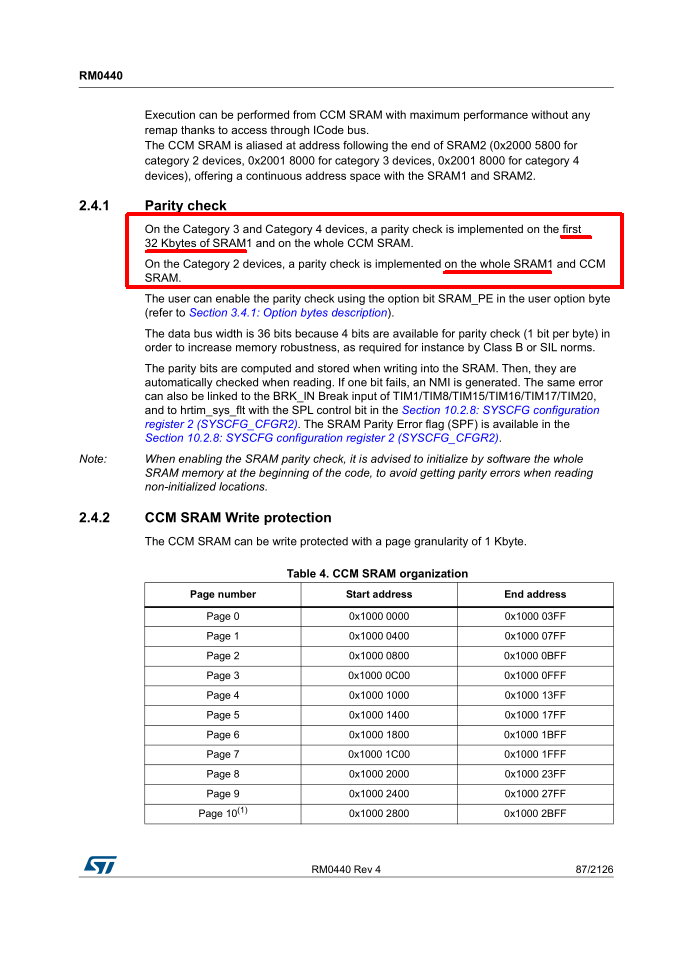

I'm using the chip STM32G431CBY3 and here is a strange thing. After I start the TIM15 in interrupt mode and every time the interrupt enters, the NMI_Handler enters at the same time, by checking the register, I found that SRAM_PEF bit is set in SYSCFG_CFGR2. After several times of this, the system seems to stop working.
I have done things below by using the methods mentioned in knowledge article type 'How to use SRAM Parity in your application' :
  1. Enable SRAM parity check in STM32CubePrg, make CCMRAM erased when system resets;
  2. Initialize the SRAM in startup file;
  3. Clear the SRAM_PEF bit in NMI_Handler;
but that brings no effect.
By the way, I use CCMRAM to accelerate some functions, the CCMRAM is mapped at 0x10000000, when I remap it at 0x20005800, the problem above disappears and the code works right. I have checked the variables that DMA used, their run address are all at RAM not at CCMRAM, so I guess it's not about DMA access? If somebody knows the reason please tell me. Thanks.

Hello @jhu.5​,
You should not rely entirely on the knowledge article 'How to use SRAM Parity in your application' as it uses the NULCEO-G071RB, which differs from the STM32G431.
For instance, it is not clear how you're checking the SRAM_PEF bit since it's not a part of the SYSCFG_CFGR2 register in STM32G431.
Also, unlike the STM32G0, the SRAM size does NOT change if the parity check is enabled.
It'll be helpful to get an update from you!
