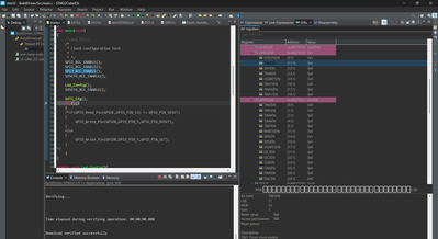

I write drive layer in MCU which is stm32f302r8t6. But I can't active to enable SPI clock register.
Can you help me with that problem?
Maybe you ask me that write in main.c as register level.
RCC->APB2ENR |= 0x0800;
Actually I opened SFR and tried to enable SPI clock register but I can't.

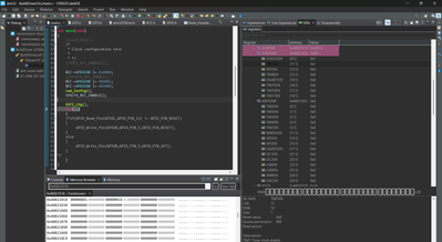

I did write 0x1000. But it is not change. if you look picture you can see what I made
Streamer

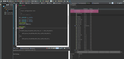

If you look picture. SPI2 and SPI3 is enable but SPI1 isn't still enabled. maybe it has protect? or it is not true hardware
STTwo-32
Sorry for this mistake. the SPI1EN is available only on the STM32F302xB/C devices only (According to the RM0365:(
So, SPI1 is not available for the stm32f302r8t6 (only SPI2 and 3).
