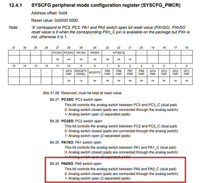

If you are using ADC and GPIO output on PA0x, you need to use PA0_C for the ADC input and PA0 for the GPIO output not the inverse. with the analog switch OPEN.
Meanwhile, PA0_C can be used as GPIO if the corresponding switch Pxy_SO is closed. So PA0 and PA0_C are connected and the alternate functions available on PA0 will be also available for PA0_C.
You need just to ensure that the switch is closed:
HAL_SYSCFG_AnalogSwitchConfig(SYSCFG_SWITCH_PA0, SYSCFG_SWITCH_PA0_CLOSE);

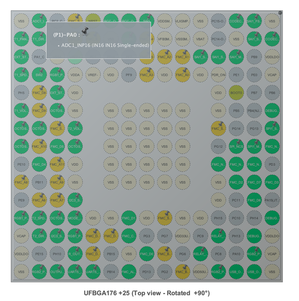

Sharing screenshots of PA0_C and PA0 configuration. Note that PA0_C does not work even if I deactivate the ADC function on PA0.

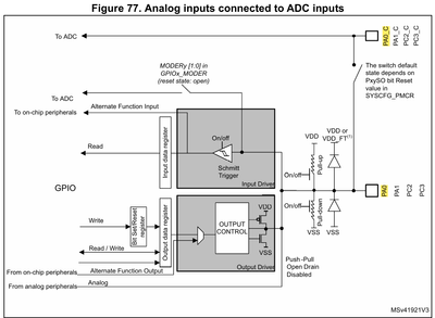

PA0_C cannot be used as a GPIO independently of PA0.
You cannot use PA0 as an ADC and PA0_C as a GPIO.
You can use PA0_C as an ADC pin and PA0 as a GPIO.
If you're having issues or think an IOC is generating bad code, please attach it here so someone can take a look.

The Reference Manual seems consistent to me in explanation, especially Figure 77. Only thing PA0_C can do on its own (i.e. without the analog switch) is ADC. When the switch is closed, the two pins are tied--they are no longer independent.

The reference manual for the STM32H730 is RM0468.
https://www.st.com/resource/en/reference_manual/rm0468-stm32h723733-stm32h725735-and-stm32h730-value-line-advanced-armbased-32bit-mcus-stmicroelectronics.pdf
https://www.st.com/en/microcontrollers-microprocessors/stm32h7-series/documentation.html
The Reference Manual will describe how the chip family works in detail. By contrast, the Datasheet has more chip-specific information.
