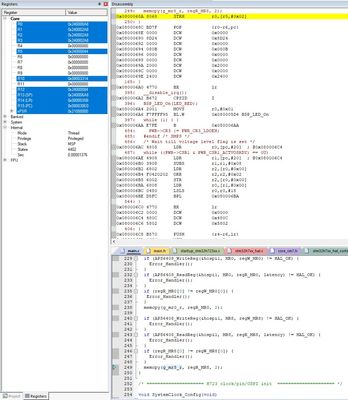

I have ported the code from the link for the H723 but encountered an error.
When calling the function HAL_OSPI_Receive(Ctx, Value, HAL_OSPI_TIMEOUT_DEFAULT_VALUE) , an error occurs in the file stm32h7xx_hal_ospi.c at the following lines:
  • *((__IO uint8_t *)data_reg) = *hospi->pBuffPtr;
  • hospi->pBuffPtr++;
I am also attaching the memory datasheet.
Thank you.
The disassembly doesn't look viable for sure. Not sure it the core has locked out access, or the pod is not connecting. So not sure stopping or stepping here is productive at this point.
I'd also caution on placing a peripheral watch view, as this tends to interfere with the operation of FIFO and stateful registers. Add some app side dumping or telemetry if possible.
You can inspect RAM based peripheral instance structures.
For Hard Fault situations.
https://github.com/cturvey/RandomNinjaChef/blob/main/KeilHardFault.c

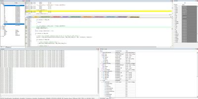

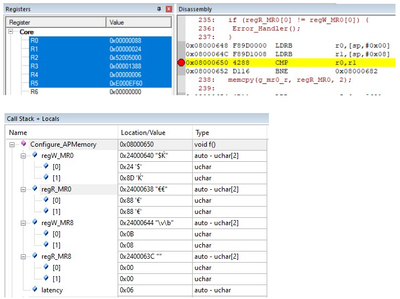

Thank you for your answer; it helped me make progress.
The code execution advanced further after I disabled the System Viewer window. However, it now gets stuck while comparing the values of the MR0 and MR8 registers.
Does this information from the debugger indicate a real issue, or could it just be a debugging artifact?
Furthermore, could displaying the MR register values in the Call Stack and Locals windows somehow be influencing their actual values?
See below comments

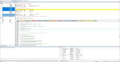

1. Where is the memcpy() of line 249 disassembled?
There should be something like "B 0xXXXXXXXX memcpy" right after the 0x0800065A as in 0x0800064A, then RET.
2. Run until 0x08000658 CMP instruction, so that you know the exact r0 and r1 value
Determine which is regR_MR8[0] and which is regW_MR8[0]. Compare them with those in call stack locals at bottom right.
3. Which is the right value you want? 0x44, 0x3C, or something else?
I saw regR_MR0[0] and regW_MR0[0] are different, maybe the XSPI timing is totally misconfigured?
Thank you for helping me figure this out.
1. For the first question - pic1.
2. For the second question- pic2.
3. MR0 and MR8 values: I took them from the code at this link ([https://github.com/STMicroelectronics/STM32CubeU5/blob/main/Projects/STM32U575I-EV/Examples/OCTOSPI/OSPI_PSRAM_MemoryMapped/Src/main.c]):
`uint8_t regW_MR0[2]={0x24,0x8D};`
`uint8_t regW_MR8[2]={0x0B,0x08};`
The reason I used them is that I couldn't understand how to derive these values based on the memory manual. According to my interpretation of the manual, I got different values: MR0 = `0xC0, 0x01` and MR8 = `0xC0, 0x8D`.
