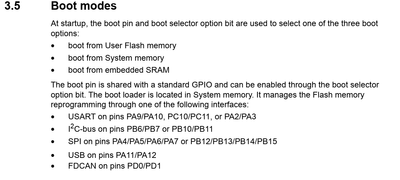

>2. maybe : almost all have...? and see ds of any cpu , about boot:
G0 here, just because i had open..

I think USB-DFU is fairly universally supported, but obviously it's not in all parts since some don't have USB support anyway. You could look at AN2606, which organizes information about the bootloader across all STM32 families, you should find what you need there. Obviously, there might be missing information, but I think you will find it useful anyway.

Check in the reference manual in "1.4 Availability of peripherals"
waclawek.jan
In 'G0 family, only'G0Bx/'G0Cx (which is the same for with disabled/enabled crypto) have USB at all, so there is no point in checking USB/DFU bootloader in other models (as been said, in AN2606).
