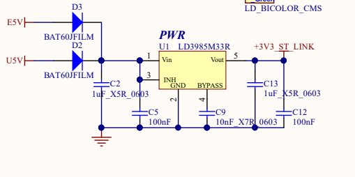

I powered the NUCLEO-F410RB board externally by changing the JP5 jumper to select the E5V power supply and applied 5 V to the E5V pin. Initially, I did not have an external ST-LINK, so I switched JP5 to U5V and programmed the Nucleo board through USB.
During this back-and-forth process, I powered both internally and externally at a time. After this, the board started consuming more current, and U1 in the NUCLEO-F410RB schematic overheated. Eventually, the VOUT and GND pins were found to be shorted.
After troubleshooting, I found that the short was inside the on-board debugger IC (ST-LINK), between VDD and VSS, so I removed the debugger IC.
Later, I purchased an external ST-LINK and tried to program the Nucleo board again. I powered the board externally with 5 V on E5V. The main MCU is getting 3.3 V, but there is almost no current consumption, whereas earlier it used to draw around 200–700 mA.

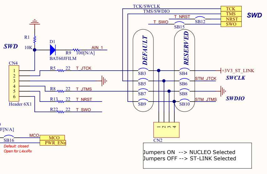

For debugging, I removed the CN2 jumpers and made the following connections:
CN2 pin 2 → ST-LINK TCK/SWCLK (pin 9)
CN2 pin 4 → ST-LINK TMS/SWDIO (pin 7)
When I try to detect the target using STM32CubeProgrammer, I get the following error:
Error: No STM32 target found! If your product embeds Debug Authentication, please perform a discovery using Debug Authentication.
Could you please help me understand what might be wrong and how to recover or further debug this board?

Uwe Bonnes
Chief
For an external STLINK you need a four wire connection. At least GND is needed additional to SWCLK/SWDIO. Target VSS may be needed to adapt thze logic levels of the Stlink to the target.
I tried it. Still its same.
