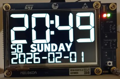

I did exactly now on this devboard RTC with additional functions like pictures slideshow and so on.
Maybe will be helpful the code of RTC project.
https://github.com/wegi1/STM32U5G9J-DK2-RTC

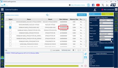

I'm not sure in this kit external flash can be mapped at 0x90000000  bcos external loader working at 0xA0000000:
