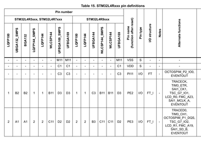

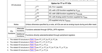

The STM32L4P5xx does not have LCD controller (as in the segment-LCD controller - it does have LTDC, but those pins are normal CMOS outputs, not powered from a special power structure); and, relatedly, it does not have VLCD pin either.
Btw. I found VLCD references and also the _l suffix at various pins (even _l explained) in STM32L4R5xx, STM32L4R7xx and STM32L4R9xx datasheet (DS12023 Rev 5), too. Didn't check other L4+ models.
from ds L4Rx : ...same pin/functions
...and _l in table:
Needs correction in the ds L4P5 , i suppose.
waclawek.jan
As I've said, neither the 'L4Px nor 'L4Rx do have the LCD module, nor the VLCD pin.
IMO references to VLCD and the _l IO structure shour be removed from both datasheets (plus their crypto counterparts', if it's there too).
