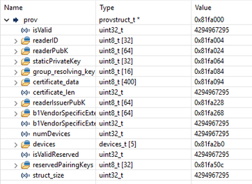

Hello everyone,
I am currently working with the Aliro software expansion for STM32Cube using the new STEVAL-ALOCKCB board (Aliro access control reference design based on STM32WBA65RI, ST25R300, and STSAFE-A120).
Both the hardware and software are in their original, unmodified state from ST. The nfc12ble project builds successfully without any issues.
However, I am encountering a consistent problem:
the function CryptoInit() always returns false.
From debugging, I can see that the failure originates from the CheckReaderPubK() function, which internally calls isValidProvisioning(). This function also returns false, causing the entire initialization to fail.
It seems that the provisioning structure is not considered valid. In particular:
  • The check prov->isValid == DEVICE_PROVISIONING_STRUCT_IS_VALID fails.
  • DEVICE_PROVISIONING_STRUCT_IS_VALID is defined as 0xA5A55A5A (decimal: 2779077210).
  • However, the actual value read from flash appears to be different (e.g., 0xFFFFFFFF), which suggests that the flash is not programmed.
From my understanding, this indicates that the board is not provisioned, even though I am using it in its default state.
My questions are:
  • Is it expected that the STEVAL-ALOCKCB board is delivered without provisioning?
  • Do I need to manually program the provisioning data into flash before CryptoInit() can succeed?
  • If so, what is the recommended procedure to correctly provision the board?
Any guidance or suggestions would be greatly appreciated.
Thank you in advance for your support.

bool CheckReaderPubK(void)
  showJsonStatus();
  if (!isValidProvisioning(getProvisioningFromFlash()))
    PLATFORM_LOG(VERB_NORMAL, TEXT_COLOR_RED);
    PROVISIONING_LOG("\r\nBoard is not provisioned\r\n");
    PLATFORM_LOG(VERB_NORMAL, TEXT_COLOR_DEFAULT);
    PROVISIONING_LOG("Use 's' command to load default keys\r\n");
    PROVISIONING_LOG("Use 'c' command to convert keys from embedded json\r\n");
    PROVISIONING_LOG("Use '?' for help\r\n\r\n");
    return false;
  else
    PROVISIONING_LOG("Board provisioning ok\r\n");
    return true;
bool isValidProvisioning(provstruct_t *prov)
  if(prov->isValid == DEVICE_PROVISIONING_STRUCT_IS_VALID)
  //is valid
    if(prov->struct_size == sizeof(provstruct_t))
      PROVISIONING_LOG(TEXT_COLOR_GREEN);
      PROVISIONING_LOG("Provisioning info is valid\r\n");
      PROVISIONING_LOG(TEXT_COLOR_DEFAULT);
      //print b1VendorSpecificExtension
      PROVISIONING_LOG("b1VendorSpecificExtension: \"%s\"\r\n", prov->b1VendorSpecificExtension);
      return true;
    else
      PROVISIONING_LOG(TEXT_COLOR_RED);
      PROVISIONING_LOG("Provisioning info is present, but wrong version\r\n");
      return false;
  else
    PROVISIONING_LOG("Provisioning info is not valid\r\n");
    return false;
