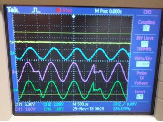

I have a custom board with an STM32F412re and a TLV320aic Codec, where the Codec is in Master mode and the I2S2 Interface of the STM32 in Full Duplex Slave mode.
So far I have the I2S2 interface configured to send and receive the data over DMA.
On DMA transfer complete Interrupt I copy the input buffer (uint16_t) to the output buffer.
This way I have a passthrough of the audio signal.
Now I also implemented the float32_t FIR example from CMSIS/DSP. I have verified, that the FIR filter works (amplitude shows low-pass characteristic). However I am seeing (and hearing) that the audio signal has gaps.
(blue: Input, 1Vpp, 1kHz. green/pink: Line Out L/R)
I suspect that this happens because I execute the FIR filter inside the DMA ISR - which is not the way to do it. The next step is to implement a buffering method to run the FIR-Filter not FFT (as in the comments) n the main loop.
How can this be achieved? What is good practice? Is there an app-note or a white paper explaining how to implement a buffer for this application?

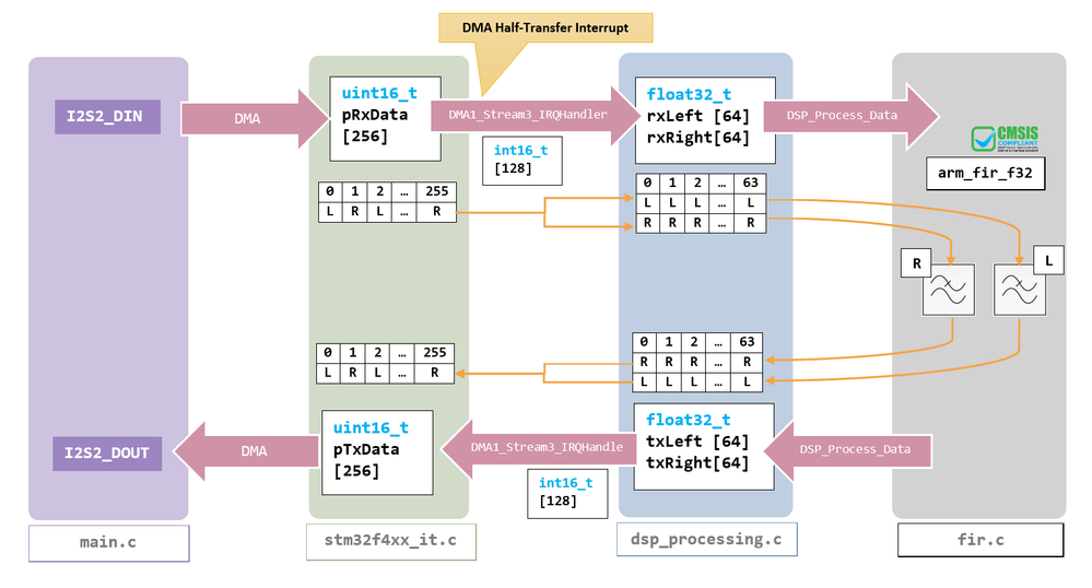

I was now able to implement the DMA Buffer with an interrupt on half-full. Another issues was in how I implemented the FIR filter with the wrong parameters.
The DSP routine (including the FIR) is still called in the ISR as the processing time is much less than the buffer length times sampling period.
DMA runns on the pRxData[2 * DSP_BUFFERSIZE] and pTxData[2 * DSP_BUFFERSIZE]

I've used DMA to a circular buffer of length exactly twice the amount of data I choose to process in one chunk.
When I get the DMA half-transfer interrupt I know the first half has good data (and the second half is filling up). So I can do what I want with the first-half data.
When I get the DMA transfer complete interrupt I know the second half has good data. As I set the buffer to circular, I know the first-half is now filling up while I process the second-half data.
If you want to use more than 2 buffers, then you should use the double-buffer* mode so DMA can continue while you are updating the pointers for the currently-inactive buffer. Sorry I don't know how to do it with HAL - I generally go direct to registers because I find the Reference Manual better-documented that HAL.
Do you have modify the data during copy? Do the the input and output devices run on different clock?
If both answers are "no", then forget about copying the data, just start two circular DMAs of the same length, one receiving, one transmitting, into the same buffer.
That's it, and you can completely forget about the stuff then.
If you need to modify the data - e.g. amplify/attenuate - it's still two circular DMAs, but to/from two buffers, with the copy in the half-transfer interrupt, as Danish said above. There's again no reason to stop/start the DMAs ever.
If the clocks differ, that's the most tricky one - but only in the math involved in the copy; it's still two circular DMAs, never to be stopped/restarted.
In the latter two cases, the copy and/or processing performed in the half-full interrupt needs to be carefully benchmarked so that it always fits into the slot given by the data rate. Impact of interrupts of higher priority MUST be included in its worst-case scenario. Calculating/measuring execution times and latencies is a basic skill of mcu the programmer.
In any case, FFT just picks data from the input buffer to its own as Ozone said (unless this step can be omitted and data can be processed directly as they arrive, in which case you simply leave them in the inbound buffer), and processes - this can be triggered by the interrupt and processed elsewhere. If FFT can't keep up with the data rate, then it's just that data which is corrupted, not the feedthrough.

DMA Half-Transfer Interrupt was what I needed. Thank you for pointing this out.
