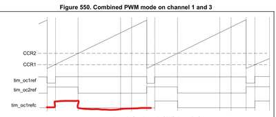

2026-01-28 11:30 AM - edited 2026-01-28 11:31 AM
Have the pulses start on tick 1 instead of tick 0. Set up CH1 and CH3 in combined PWM mode 2, others in PWM mode 1.
CCR1 = 1
CCR2 sets top pulse
CCR3 = 1
CCR4 sets bottom pulse
Reverse polarity of the bottom pulse.
2026-01-28 11:45 AM
Thank you very much for your help. I am afraid I am a bit new. Could you point me to an example about it?
Kind regards
