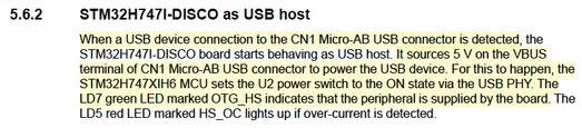

According to the reference manual, LED7 should light up green when the ULPI PHY detects a USB connection and the board is acting as a host. In my case, this LED turns on even before connecting any USB device.

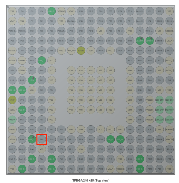

Also, this function writes a pin that is not set in the FW (GPIO Pin 5 Port H):

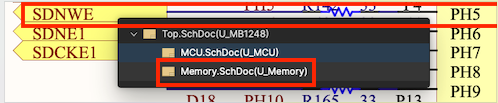

In fact, this pin corresponds to one input pins of the RAM memory:
screenshot from the design files MB1248-H747I-D03 (downloaded form ST)

Am I missing something in the setup? I was expecting LED7 to remain off until a USB mass storage device is actually connected.
