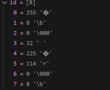

I have a W25Q128JVIQ connected to an STM32F446RE like the following:
I am trying to use QuadSPI in Dual Mode, but I am having difficulties reading ANY data, like the Device ID (ABh). This is my code:

I also tried to read instruction 92h with datamode and address mode set to DATA_2_LINES, but it returns the same.
I am pretty sure, this is not the ID, it should return 23 or 238 according to the datasheet. I tried everything I could think of. Here is my QUADSPI init:

com.Instruction = W25Q_FULLID_DUAL_IO;         // Command
com.DataMode = QSPI_DATA_1_LINE;
Really?
Perhaps stop random shot-gun coding..
0x9F would be 1-bit command (x8), and 1-bit data (x24), no address or dummy bits. Returning 0xEF,0x40,0x17  (239, 64, 23)
If that doesn't work evaluate what exactly you've wired and configured.
Try with hqspi.Init.ClockPrescaler = 10; so as not to be maximally clocking
0xAB would need 3 dummy bytes (24 clocks), or 3-byte address of non-consequential content.
Inspect signals with a scope or logic analyzer
Show pin configuration code

I managed to make it work!

If i call the readID twice, the second time it returns 255, because the chip is already awake. First time it returns 0. Afterwards, I call the readFullID, and it returns this:
Why is the first index 0? according to the datasheet, it should not be there. Could you help me understand this?
