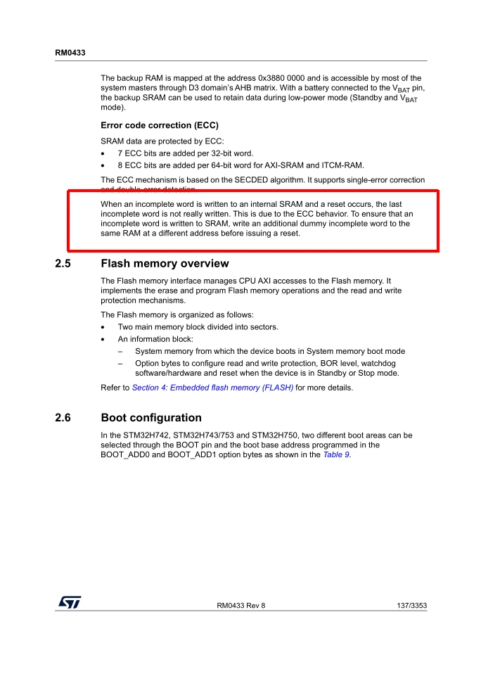

Since several weeks I had program loading issues using Lauterbach Trace32 debugger on a STM32H753.
It came out it is due to the issue described here: https://community.st.com/t5/missing-articles/faq-stm32h7-sram-backup-sram-content-is-not-preserved-after/m-p/49291
Basically one 16 bits instruction of my code does not "fill" a whole SRAM word (as explained in the FAQ) and so it is written in the RAM cache and not in the real RAM.
When the debugger does a reset after the loading, this instruction is lost.
I have several questions:
- I feel that the issue should occur with any debugger and on any software. How are other debugger tackling this specific issue ?
-  The FAQ states that: To flush this cache after "word-unaligned" access, there are two options: perform other "unaligned" access to other SRAM word, perform read and write aligned operation on the same SRAM word as the last access. From my trials I think it should be: perform other write unaligned access. I noticed a read unaligned access is not sufficient. Could you confirm ?

waclawek.jan
July 23, 2024
> This STM32H7 ECC issue is a major gotcha, IMHO should be included in the errata for all affected products.
It's in the RM, at least for 'H743 and kin:
> With GCC even if you add a ". = ALIGN(8)" directive after a section, the size of the section is still not a multiple of 8 bytes.
Try adding
. = ALIGN(8);
at the end of given section.
jw
Gpeti
GpetiAuthor
Senior
July 23, 2024
Try adding
. = ALIGN(8);
at the end of given section."
That's exactly what I did. Doesn't change the size of the section (in the .map file at least), it only adds some zeros in between sections.
I think it is better to do as suggested in the Ref manual ie. do a dummy write access at another adress.
