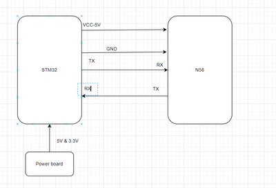

I am working with STM32g491re custom board. With UART communication our STM32 and other MCU communicating.
After flashing the firmware with debugger both boards are communicating properly but once power off & on If other board sends the data stm32 is not responding at all. Again if I flash the firmware by connecting the debugger again both boards are communicating.
UART communication I implemented interrupt communication.
Can anyone suggest what will be the reason both are communicating only with debugger.
Thanks

Andrew Neil
Tell more about these boards, how they communicate, and how they are connected.
Schematics and some good, clear photos would help.
Could it be that you're missing a ground connection, and the debugger provides that?

Another possibility when stuff "only works with debugger" is that your board is not properly resetting the microcontroller ...

Hi @Andrew Neil ,
One is STM32G491RE and other is N58.Both are communicating through STM32.Data format defined for both boards.
Based on the data received from N58 ,Stm32 responds to N58.\
Schematics I can't able to share it.

what is "N85" ?
If not full board schematics, at least a schematic of how the boards are connected together.
You've also mentioned a "web server" - so how does that fit in?
Again, some good, clear photos would help.
Remember that we know nothing about your system other than what you describe here - if you can't find the problem(s) when it's your system, and you know what it does and how it all connects and you have it right there in front of you - how do you expect people with no information and no access to do any better?
Do you not have colleagues / classmates / supervisors to help you?
You've come to a public forum for help, at the very least you can diagram the salient connections to establish what you've built, without telekinetic abilities of the participants here.
Do the boards share a common ground?
Do the Output signals on one board go to the Input on the other?

Another thing you haven't said is what debugger you're using.
Does it supply power to the board?

1.
N58: Neoway N58 is an LTE Cat. 1 module optimized specially for M2M and IoT applications
https://www.euromobile.ru/upload/iblock/8e5/Neoway_N58_Datasheet_V1.1.pdf
2. About schematic:
I know I am sorry for the inconvenience  I will check with my team what things can I share in the forum.
3.
STM32 supplies 5v supply and ground to the N58 board.
Debugger I am using is Segger Jlink debugger.I only connected SWD lines and ground to PC.VCC line I didn't connected to the STM32 and debugger.
My issue some how solved after giving some delay in the uart receiver callback of stm32.
Does debugger provides some delay to the programming??
Thanks
That sounds like a flaw in your comms handling; eg, your code is not ready at the point that the modem sends stuff.
You need to debug that - otherwise it's likely to come back and bite you later ...
