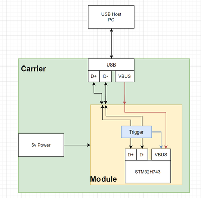

‎2024-05-27 11:51 AM
I should have been more clear.
I have a "Module" (Yellow) which contains some supporting circuitry and some sensors.
It is normally soldered onto a "Carrier" (Green) which has a USB plug to act as a slave to a host PC.
The problem is that the Module is small and has limited space for edge connections, so I am trying to avoid dedicating one to VBUS sensing. Is there anything I can do using just the Data signals to trigger VBUS (Blue) rather than dedicate an edge pin (Red)?
My Module is powered through a 5v power input, which might or might not be self powered/bus powered so cant be directly tied to VBUS (through a resistor divider). What happens if VBUS is always tied high but there's no USB attached?
‎2024-05-28 2:59 AM
I guess it would not be possible to get a direct solution for triggering the VBUS pin using only the data lines. The standard approach for VBUS sensing involves detecting the presence of the VBUS voltage itself, not through the data lines.

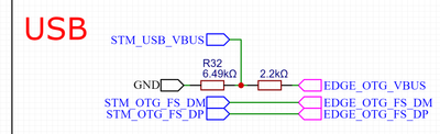

I have since got another board revision made that has the VBUS broken out separately but still have the same device descriptor request failed error.
Vbus is triggered through a Voltage divider as pictured below which is only active when the USB is plugged in.
I am using ChibiOS and have the VBUS sense pin set to an opendrain input.
