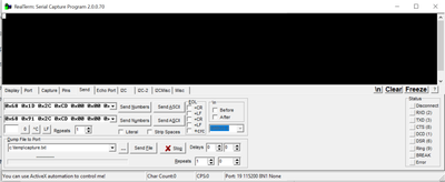

I am sending data with RealTerm. Short messages work just fine, but then I need to send 147 bytes. In the debug, I can see from the state of huart2 handler that RxXferCount starts at 147 and decrements until 98. Then, UART_RxISR_8BIT is never called again, the state remains unchanged until firmware's timeout triggers and aborts the reception.

After a couple of tests I found out that Realterm v2.0.0.7 does not send more than 49 bytes in one go for some reason. I used a makeshift python script to send the data and it worked. Good grief, threw me for quite a loop.

@MO94 wrote:I transmit data using a serial terminal from my PC, RealTerm.
How, exactly, do you do that?
Are you typing characters manually, one-by-one, or getting RealTerm to send them all together as a block?
If the latter, perhaps you are too slow in your receive handling, and you are getting UART overrun ... ?
If the former, you should be able to follow it in the debugger, and see what changes at 98 ...
‎2025-05-29 3:44 AM
I send the whole message package together by inserting the data and pressing Send Numbers.
As I mentioned in my post, I checked the overrun by reading __HAL_UART_GET_FLAG(&huart2, UART_FLAG_ORE) when the timeout happened and the value was 0.
In the debugger, I tried to follow the communication and saw only that past 98 counter value the interrupt is not called anymore.

@MO94 wrote:I send the whole message package together by inserting the data and pressing Send Numbers.
So try doing it manually; or perhaps RealTerm lets you put a delay between characters ...
