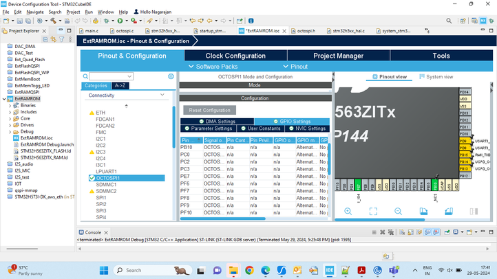

In first method, i am facing addressing problem for the second device in memory mapped mode.
I tried 2nd solution but i couldnt keep both NCS pins in the configuration. If I select second NCS pin, it is replacing with first one. Should i need to configure 2nd NCS pin as normal output pin and manually do the high or low for the second device?

Yes, I seriously doubt CubeMX/IDE is going to facilitates this at the auto-gen level, you'll have to take the training wheels off and code this behaviour yourself.

-->I tried 2nd solution but i couldnt keep both NCS pins in the configuration.
Which mode OCTOSPI are you using in STM32CubeMX?
With STM32CubeMx toolchain, you are able to configure only one memory. For that, I recommend you to code this behavior manually.

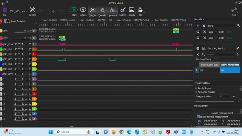

I am able to switch the NCS functionality to other pins from PE11(NCS1) to PB10(NCS2) with manual coding but even though i choose ioselect as 0 to 3 or 4 to 7, the data is reflecting in other half. I chose single memory configuration only not dual quad configuration. Is this the expected behavior?
In this below pic you can see first data 06 (used HAL_XSPI_INSTRUCTION_1_LINE) i am sending to device A by making NCS pin low after that i am making NCS high (Deactivate device A and switching to Device B). Sending same data 06 to Device B by making NCS2 pin low. In this both the scenario you can see same data flowing through IO0 and IO4 but it is supposed to be go either IO0 or IO4. May i know the reason?
