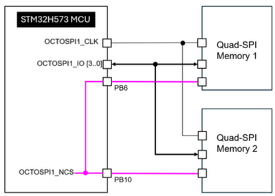

I have been trying to connect PSRAM and NOR FLASH to STM32H563 nucleo board using Dual-Quad-SPI.
I was able to successfully read/write to PSRAM and NOR Flash individually in single-Quad-SPI mode with base address 0x90000000. i'm not clear how the addressing is taken care, when we connect both PSRAM and NOR Flash in dual-Quad-SPI mode.

Hello @shii and welcome to the Community :),
When DMM = 1 in OCTOSPI_CR, the OCTOSPI is in dual-memory configuration: if DMODE = 011, two external Quad-SPI devices (device A and device B) are used in order to send/receive eight bits (or 16 bits in DTR mode) every cycle, effectively doubling the throughput.
If address X is even, then the byte that the OCTOSPI gives for address X is the byte at the address X/2 of device A, and the byte that the OCTOSPI gives for address X + 1 is the byte at the address X/2 of device B. In other words, the bytes at even addresses are all stored in device A and the bytes at odd addresses are all stored in device B.
Thanks to alternate function, you can connect a PSRAM and NOR Flash memories using one OCTOSPI interface. So, you can use different GPIOs to mange the chips select and the clock.  The software should configure the chips select and the clock for the memory to be accessed.
For more information about the Dual-quad configuration, I advise you to refer to RM0481 "Dual-quad configuration" par graph under "23.4.5 OCTOSPI regular-command protocol signal interface" section and Figure 141 OCTOSPI block diagram in dual-quad configuration.

Hello @Nagarajan ,
To clarify my last comment, for dual quad mode, both devices must be identical, because in this mode the same commands and addresses are issued in parallel to both memories.
When DMM = 1, the bytes at even addresses are all stored in device A and the bytes at odd addresses are all stored in device B, as detailed in  RM0481 "Dual-quad configuration" section.
But it is possible to connect 2xQuadSPI memories using only one OCTOSPI instance.
There are 2 possible solutions:
  • Use a dedicated bit in OCTOSPI_CR register for external memory selection: MSEL bit  for STM32H5: The idea is to select the external memory to be addressed in single-, dual-, quad-SPI mode in single-memory configuration (when DMM = 0).
    MSEL
    0: External memory 1 selected (data exchanged over IO[3:0])
    1: External memory 2 selected (data exchanged over IO[7:4])
    This bit is ignored when DMM = 1 or when octal-SPI mode is selected.
    DMM: Dual-memory configuration bit in OCTOSPI_CR register. This bit activates the dual-memory configuration, where two external devices are used simultaneously to double the throughput and the capacity.
  • Use different chip select GPIO pins for each memory.  The two memories must be connected to the same OCTOSPI instance, then the chip select of each memory must be connected to an OCTOSPI chip select GPIO port (for STM32H573 MCU, the OCTOSPI1_NCS must be connected to PB6 and PB10) as shown in the below figure. With STM32H573 MCU, and when transferring data to Quad-SPI memory1, it is recommended to set the Quad-SPI memory2 chip select (PB10) to high voltage by using a pull-up resistor for example.KDJEM1_0-1719483765900.png

What didn't seem to be understood by some of the answering parties was that the OP wanted both devices to be mapped into independent "slots" in the memory map without needing to intervene with the controller in any way. They wanted the flash to reside at one base address and the PSRAM to reside at a different base address such that no reconfiguration would be needed to have their application code be able to access either simply by a memory access to the appropriate region.
I can now see that this is simply not going to be possible as there is only one logical chip select for each OCTOSPI/XSPI peripheral. Even of the second schematic method of using two pins for the chip select and "masking" one or the other by reconfiguring the GPIO as either pull-up or as the appropriate Alternate Function would require the application code or a driver to intervene and switch chip selects, which rules out being able to use DMAs efficiently if at all. Furthermore, both the flash and the PSRAM would reside at the same physical base address. Adding an external MUX doesn't help the situation although it would prevent one from accidentally enabling both devices, which could result in bus contention. It would have been nice if the split bus style's memory select control bit could also be routed to an external IO pin to control the mux but that still would not allow the mapping of each device into different base address slots.
