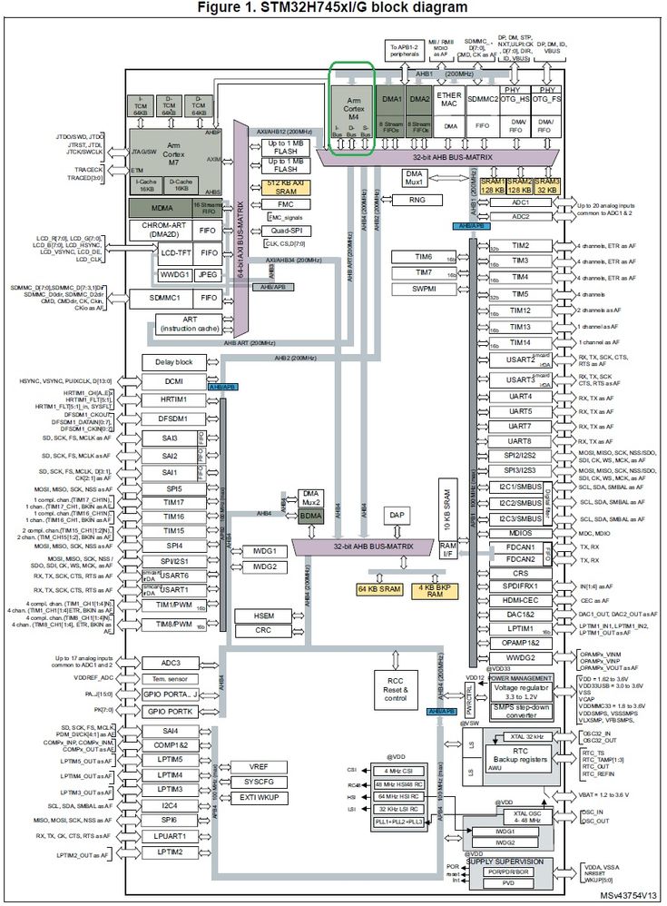

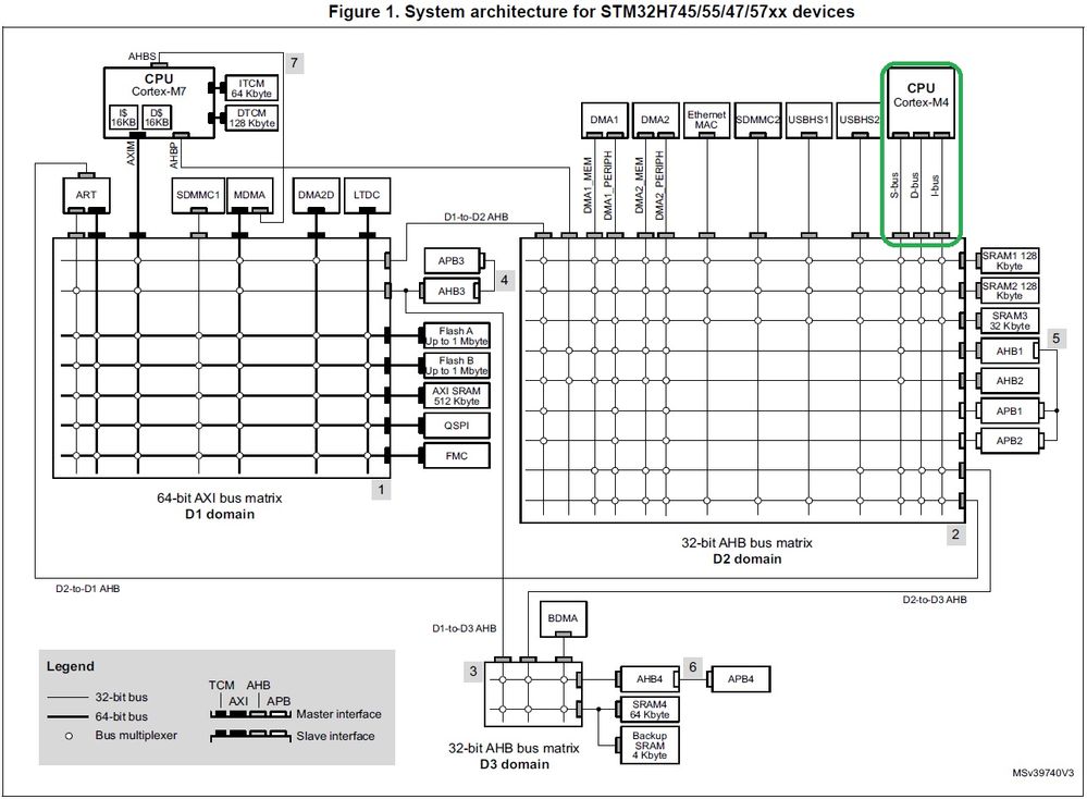

The multicore nature of the H7 was not disclosed​ for many years, this adds to the complexity significantly and explains some of the awkwardness in the design/structure. I suspect ARM and ST experimented with some things.

In which way is the H7 multicore ?

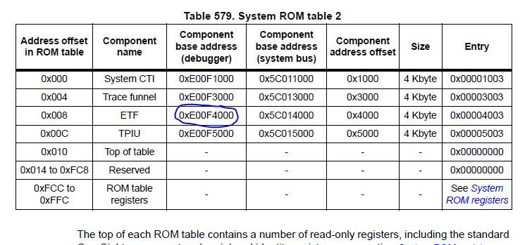

An interesting point to note: the ID registers of ETM can be read properly from the debugger (even without unlocking ETM_LAR). The ID registers of ETF are read to 0...

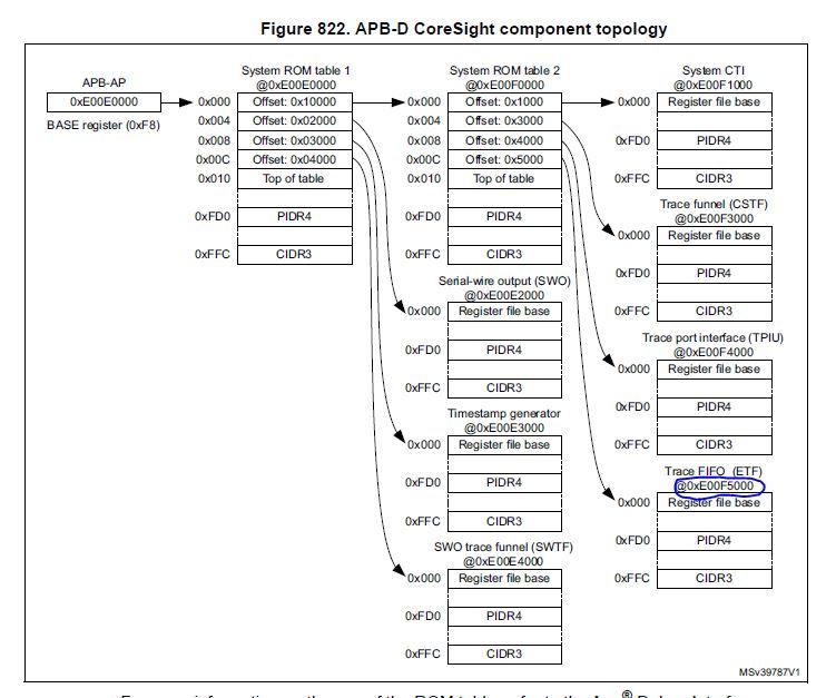

Great ! Just noticed that the STM32H7 ref manual is inconsistent on debug mappings !
Gpeti
Senior II
So if I use the address 0x5C014000 I can at least read/write ETF registers properly.

It has always been a multi-core design, it goes a long way to explaining why it is otherwise significantly more complex/convoluted in design compared to the F7, and why most of the resources are a bus ride away from where you would normally put them. It uses a SWD protocol capable of talking to multiple access ports.
