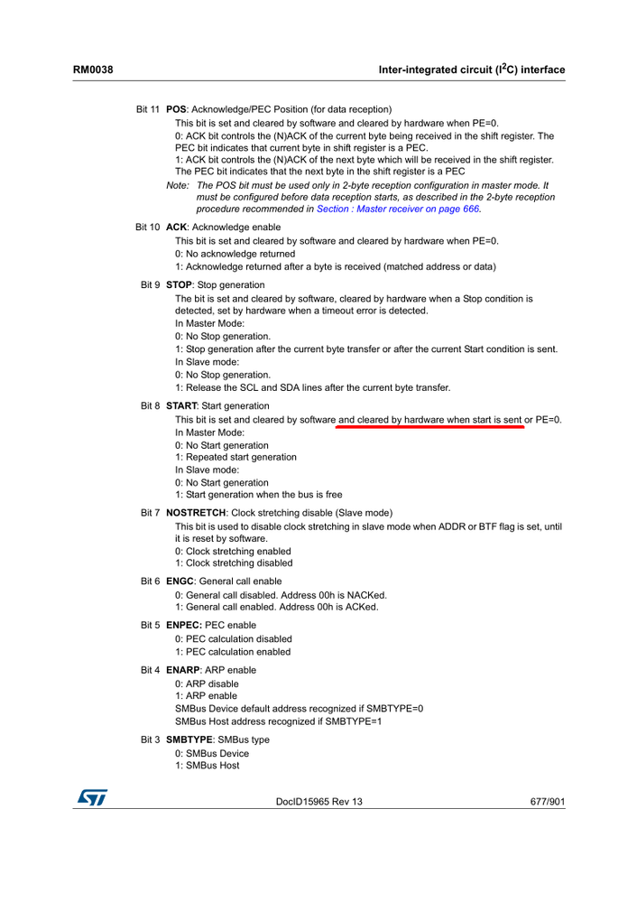

After that I set PE in CR1 (0x0001) and after that also set START bit (0x0101).
But read back only 0x0001.
LKuri.1
Ok. I see. This bit cleared by hardware.

I2Cx_CR1.START is self-clearing.
The whole I2C module is tricky, and it requires careful reading and re-reading both the narrative in I2C chapter, and the description of the registers/bits.
