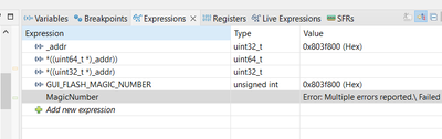

Well, _addr reports to 0x803F800 which is is the same value as the GUI_FLASH_MAGIC_NUMBER define.
HOWEVER, the line operates on MagicNumber (note case sensitivity) which is defined in the code as
static const uint64_t MagicNumber = 0xDEADBABEDEADF00DU;
Funny is, that I cannot view the MagicNumber variable in the variable watch which gives me
Multiple errors reported.
1) Failed to execute MI command:
-var-create - * MagicNumber
Error message from debugger back end:
-var-create: unable to create variable object
2) Unable to create variable object
3) Failed to execute MI command:
-data-evaluate-expression MagicNumber
No symbol "MagicNumber" in current context.
4) Failed to execute MI command:
//EDIT: Is seems indeed that i cannot read from the _addr since the expression watch does not show a number when the value is defererenced (see screenshot)
Per reference manual, the upper boundary of main flash (STM32G0B1xx) is 0x0807 FFFF, so the region 0x803F800 should be readable?

Ooooh, I had a look in the dataheet, but I had interchanged the Letters in CBT6, it is the 'B" in CBT6 that tells the 128kByte. not the 'C' which is the pincount here. Wrong order :face_with_rolling_eyes:
I changed the following define to the start of the last page (i.e. the last 2k of Flash)
#define ADDR_FLASH_LAST_PAGE	0x1F800
At least the hardfault is gone. I would say this is a bug of the code generator. Anyway: Thanks a lot @TDK !
