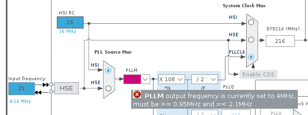

I am new on STM32 and I started a product prototype using STM32F769-Discovery. I developed all software using default clock configuration, which uses HSE.
Now I want to change to HSI, but USART is not working ( Not true, only works when board resets after downloading the program. When I disconnect USB cable and reconnect it, USART does not work anymore).
Below can find default config and my HSI config:

My config, not working (Using HSI):
* The system Clock is configured as follow :
* System Clock source = PLL (HSI)
* SYSCLK(Hz) = 216000000
* HCLK(Hz) = 216000000
* AHB Prescaler = 1
* APB1 Prescaler = 4
* APB2 Prescaler = 2
* HSI Frequency(Hz) = 16000000
* PLL_M = 4
* PLL_N = 108
* PLL_P = 2
* PLL_Q = 9
* PLL_R = 7
* VDD(V) = 3.3
* Main regulator output voltage = Scale1 mode
* Flash Latency(WS) = 7

‎2020-05-06 5:10 AM
Try it with PLLM=8 and PLLN=216 instead, adjust PLLSAIN too.
‎2020-05-11 12:00 AM
Ok, now I got:
PLLM = 8;
PLLN = 216;
PLLSAIN = 182
With these values I have fixed some issues of the GUI application running on the MCU, but USART keeps not working.
Any idea?

‎2024-10-20 11:32 AM
Did you get it working? Hava a similar problem.
‎2024-10-20 12:10 PM
HSI / HSE ?
The HSI is not an accurate/stable clock. USARTs should have some tolerance. Output 0x55 pattern, and scope. Confirm baud rate is stable enough for you host or attached system.
‎2024-10-21 4:03 AM
Thanks for your reply. Now I made it work with HSE. I think it was a "beginner problem" because I changed the HSE input frequency to 8MHz while forgetting that there is a 25MHz crystal installed. So better not change that input frequency to anything arbitrary, right :)
