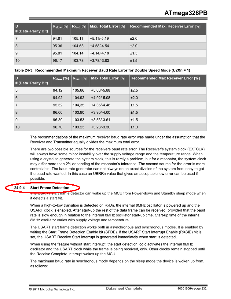

I'm modifying code for a Atmega AVR to a STM32L03 and encounter ISR(USART1_START_vect). It is a function that is called when the UART receives a start frame. I'm a newbie to this STM32-processor but I have googled and checked in inc-files but I cannot find any suitable code. I'm using HAL for now.

I have two UART ports. Both can occupy an interpreter and each port sets a flag that says "I now own the interpreter". That flag is set in this ISR().
I suppose a Frame detect IRQ coming when the hardware pin change state.
I must read about the EXTI interrupt..
I suppose a Frame detect IRQ coming when the hardware pin change state in the beginning of the transfer.
waclawek.jan
If it's this
0693W00000WLQbcQAH.pngthen as Clive said above, EXTI may be a direct equivalent. However, for the purpose you've described, IMO it's better to "flip the switch" upon reception of the first byte on given UART.
The note from 328PB is exactly what I want to happen in STM32-mcu.
