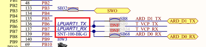

AScha.3
As i see in board circuit : on PB6/PB7 is not usart1 , but LPUART1 .
Did you setup the cpu configuration in CubeMX ?   or what you did to remap the uart's ?
mƎALLEm
Hello @TScottt and welcome to the ST community,
As shown in the table 21: D0 D1 are used for LPUART1 and not USART1:
From the board schematic:
So you can use USART2 on PD5/PD6 GPIOs:
PS: please avoid verbose request as we we can be lost in the understanding of the issue/question. You need to be concise with providing the necessary information.

How about this idea: take a DMM and check continuity or connection from/for D0/D1 to PB6/PB7 .
Then you know. ...2 minutes later...
Remember that the D0/D1 lines are usually also connected to the ST-Link Virtual COM Port (VCP).
So you'd need to break that connection if you want to connect an external signal.
Again, as @Ozone said, see the schematics & the User Manual for details.
May be easier to just use other pins?
