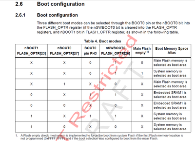

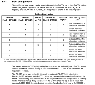

you can see in the AN2602, The STM32L4Rxxx/4Sxxx devices bootloader chapter, it is said STM32L4Rxx/4Sxx bootloader is activated by applying pattern6.
You cannot apply pattern 1 in STM32L4S5VIT6. in the reference manual there is more detail for the boot configuration.
You need to set the option bytes nBOOT1, nBOOT0, nSWBOOT0, and the boot0 pin
