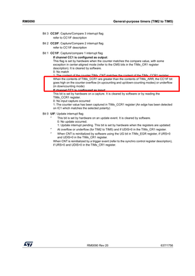

‎2024-09-03 1:45 AM
Right, my bad.
The expected behavior is to never have a compare event such as an interrupt, since the value of the counter can never become equal to that of the C/C register. What I observe is that I do get interrupts, and the value of the counter is barely above zero, which is the previous value of the C/C register, as if the new value was somewhat ignored.
‎2024-09-03 2:10 AM
That's an incorrect expectation.
‎2024-09-03 2:35 AM
Thank you very much.
