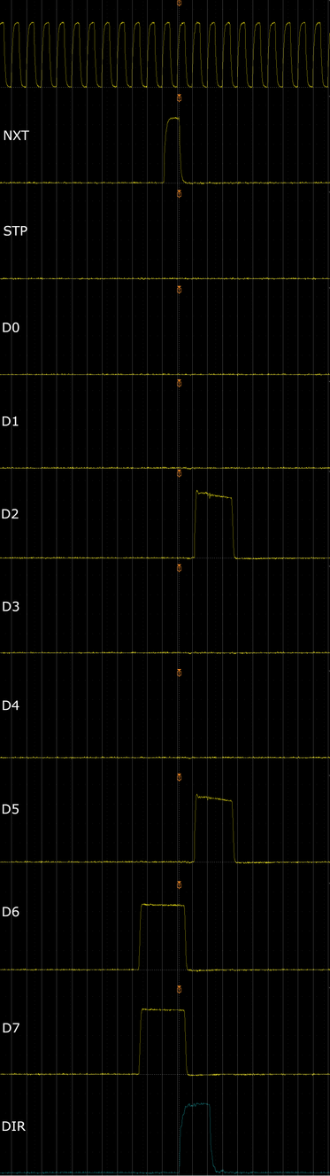

Dear all,
for the past few weeeks, I've been trying to get the STM32H753VIT6 up and running with the USB3320 ULPI interface but I have not been succesfull. First, I have tried to run a CubeMX generated USB CDC example to test the functionality, but the device was not detectable by a PC, yet the generated code was running, not hanging at any exception.
After this, I was intending to test the basic functionality by reading the interface registers (the VID in this case). For this, I have used the undocumented, but known, functions that popped up in STM's low power code for the HAL. I know that using undocumented functions pointing to undocumented registers is far from optimal, but there are no other oprtions that I know of at this time. With this, I have been able to communicate with the PHY and read the register succesfully, but, the data seemed to be incorrect. My issue was that while reading the Vendor Identifier register (address 0x00), I get a read result of 0x28 instead of the expected 0x24... Thus, I went and scoped the transaction on the bus and to my surprise, the bus data seems to actually transfer 0x24.
I'm attaching a capture of the read transfer on the ULPI. It's made up from multiple captures, as I have only one high bandwith probe, but all of them are synced to the DIR signal. All the signals (aside from DIR) are captured by a 1.5GHz probe on a 10GHz scope. The DIR is captured with a 350MHz probe, but I have checked (with the high bandwith probe) that the pulse is indeed quiet sharp without ringing and reflections. I cannot see any obvious issue with the data lines here. Looking at the USB3320 datasheet, the transfer shoul be correct in my opinion. The only odd thing is that the USB3320 response pulses (on D2 and D5) seem to decrease on amplitude with time, but I'm unsure of the cause. This behaviour can be seen on all data pins of the interface.

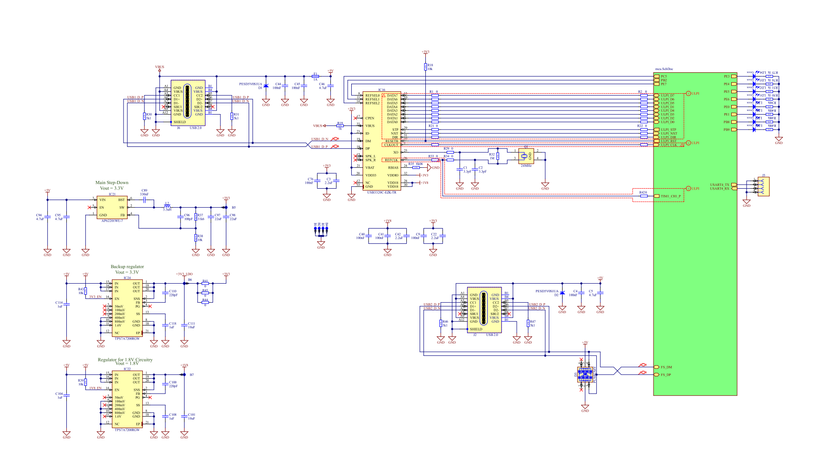

The schematic and layout files are also attached bellow. ULPI lines are length matched, impedance controlled and terminated (0R resistors in schematic have been changed to termination ones). No apparent ringing or reflection on the lines. The CLK, NXT and DIR seem a little overterminated, I've exchanged these and now they are also crisp (but I didn't bother to do a new capture here). The schematic and board supports multiple configurations. At the moment, I'm deriving the reference clock for the USB3320 from a 24MHz crystal. The DCDC is used for power but I also tested with the LDO and bench power supply, nothing helped.
The code I'm using to test is also attached bellow. There is some abstraction going on for the GPIO with a custom made library, but that has been confirmed to be working. Otherwise, it's bare metal.

Other registers than the VID also read weird values. I can also see a similar issue while writing to the Scratch Register. I tried to write the range 0x00-0xFF and read the values back. The range I've got back was 0x00-0x7F. Seems like the D7 is not getting set, but there is activity on the bus on this pin... As said, I've tried with different supplies, I've tried generating REFCLK from the STM, 12MHz crystal and 24MHz crystal. I tried to power the USB3320 from the internal LDO instead of directly from the 3V3... I tried running the STM stack, tinyusb and going bare metal. I Just kind of feel like I've tried everything :D
I would be very glad if you have any ideas on what could be wrong or have seen such a behaviour before.

Receiving 0x28 instead of 0x24 would suggests data lines are mismatched, particularly D2/D3.
Looks like D2 on the PHY chip is connected to D3 on the STM32 (among other mismatches).

Oh my, the more I've been looking into this, the blinder I was... I obviously triple checked the pinouts of the MCU and PHY, but not the sheet interconnect...
I'm gonna try to swap those and get back to you with the result.
vosahlov
This was indeed the issue. Swapped the lines and now it is working flawlessly! Thanks again!
