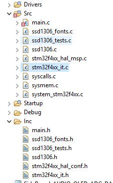

I checked it the "stm32xyx_hal_conf.h" is included in the main. but the same problem What's missing?

‎2019-08-23 5:09 AM
You only need to include stm32f4xx.h at the top level, and you need to set a define in stm32f4xx_hal_conf.h, like #define HAL_TIM_MODULE_ENABLED

Is the error coming from the compiler or the linker?
Make sure you have stm32f4xx_hal_tim.c brought into the project.
Perhaps looks at some of the working project templates for your IDE
‎2019-08-23 7:02 AM
TIM_ITConfig() is not a HAL function, is it an SPL function (the older, some would say better, Standard Peripheral Library). For example, in the STM32F4xx SPL it is defined in stm32f4xx_tim_.h. Are you perhaps trying to take code from a sample program that uses SPL and merge it into other code that uses HAL? The corresponding HAL function is a macro named __HAL_TIM_ENABLE_IT() to enable the interrupt, or __HAL_TIM_DISABLE_IT() to disable it.

Thanks. "__HAL_TIM_ENABLE_IT()" finally worked
Yes. It was my but i guess i asked the wrong question.
