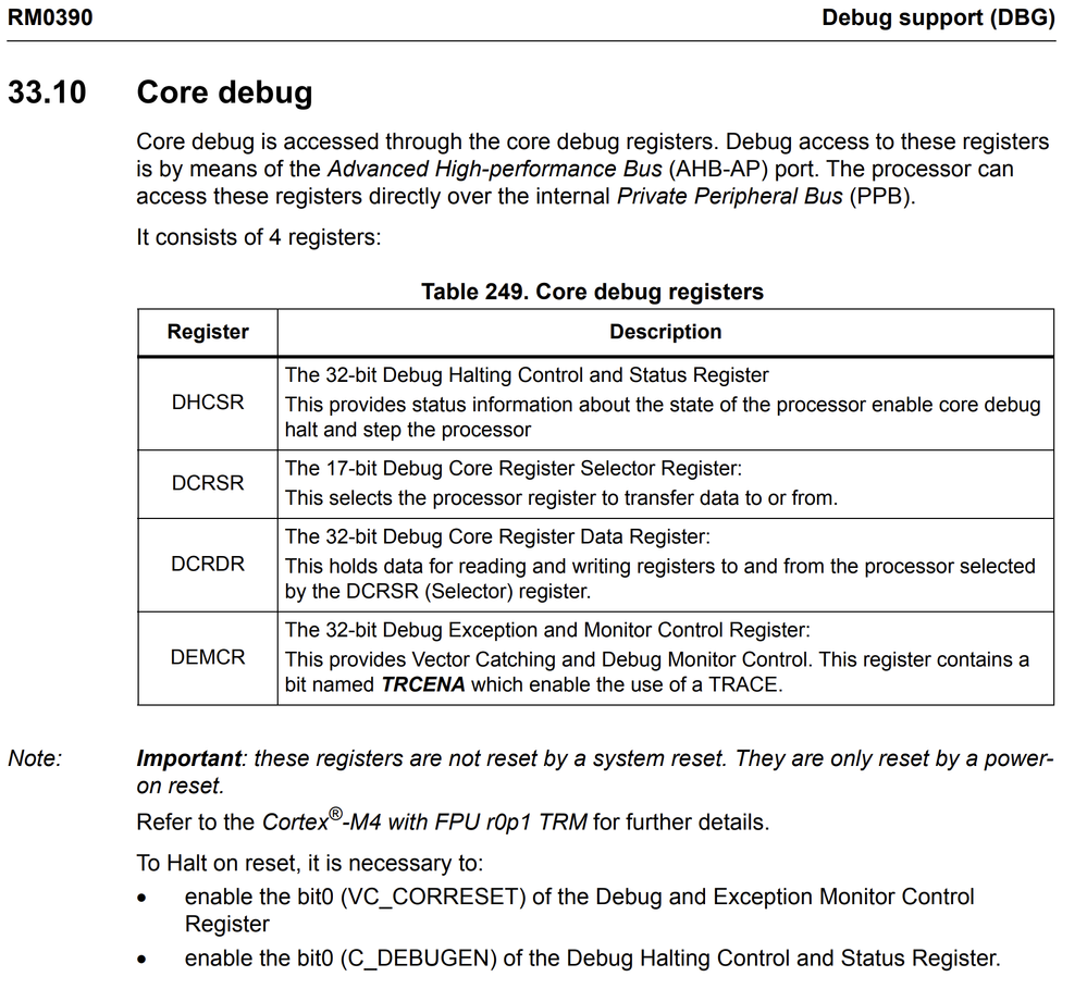

I have checked that they exist in this micro in the STM32f446 reference manual:

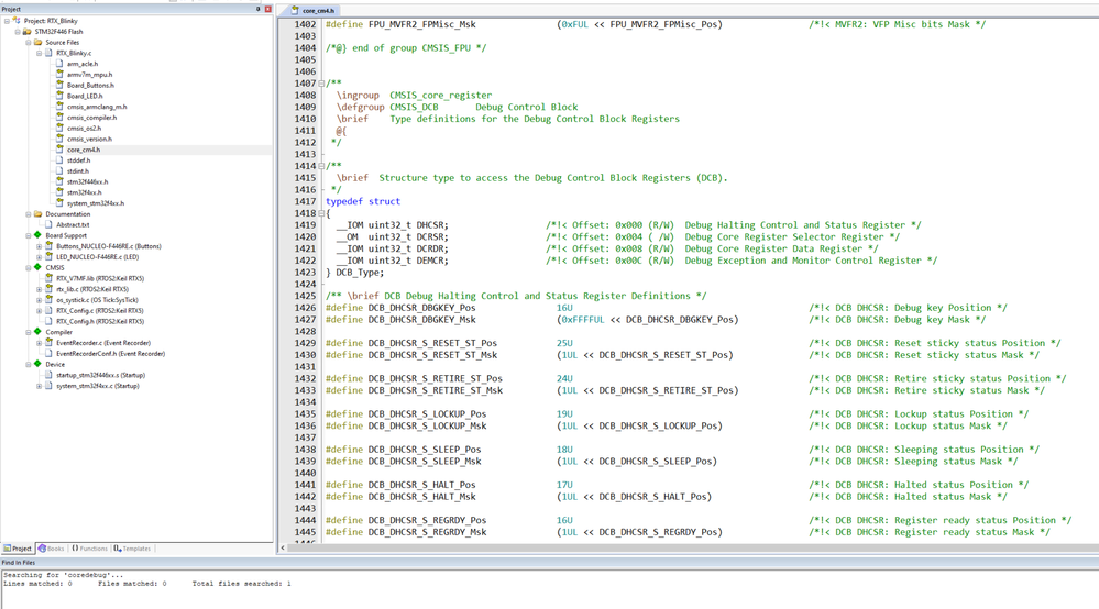

Thank you for your response TDK. I do have core_cm4.h...
But it does not include 'CoreDebug' - I can see the register definitions, but different from the code sample I posed above, and as what is used in EventRecorder.c :
if( CoreDebug->DHCSR & CoreDebug_DHCSR_C_DEBUGEN_Msk )
Where as in my core_cm4 I have the debug enable mask defined as:
#define DCB_DHCSR_C_DEBUGEN_Pos 0U /*!< DCB DHCSR: Debug enable control Position */
#define DCB_DHCSR_C_DEBUGEN_Msk (1UL /*<< DCB_DHCSR_C_DEBUGEN_Pos*/) /*!< DCB DHCSR: Debug enable control Mask */
so the core_cm4.h that I have is not using the 'CoreDebug...' syntax that is being used by EventRecorder.c. I searched for @CoreDebug' in the core_cm4.h file, there were no matches, as can be seen in the above screenshot.

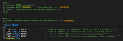

The CoreDebug definition is in the latest core_cm4.h file in the Cube repository.
https://github.com/STMicroelectronics/STM32CubeF4/blob/5983d9348e9b0c230cbe9cd2170159675f8753c6/Drivers/CMSIS/Include/core_cm4.h#L1566
I don't know where your file came from, but if it doesn't have CoreDebug, and you need it, update your library files to the latest version.
Typically this requires replacing all files, but it's possible you can get away with only replacing core_cm4.h.

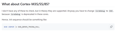

C:\Users\cider\AppData\Local\Arm\Packs\ARM\CMSIS\5.9.0\CMSIS\Core\Include\core_cm4.h from CMSIS 5.9 contains:
So it seems that Arm/Keil are moving from CoreDebug to DCB from thier move from CMSIS 5.9 to 6, but the EventRecorder.c is still looking for CoreDebug!
