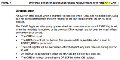

I've been wondering, how UART works in receiving side ? I have like maybe 4/5 questions ?
-> What if I have a RX buffer that is full ? The flag is on and I didn't read the data. Then the new data comes after sometime, will it overwrite my data and still the flag will be on ?
-> Is the data in the RX buffer loaded bit after bit or is it loaded whole word (8 bits) in one go and not bit by bit ?
-> How do I know when I type HAL_UART_Transmit and after that the peripheral will be sending data and after transmit command I have the command HAL_UART_Receive, so how do I know it was fast enough to read the whole data without loosing any new or old data ? Like it was to late although the commands were one after another.
-> What if I used IT or DMA, they are non blocking, and questions like above like what if I type Transmit and Receive will I make it in time ? or what if I didn't read data and the buffer sets the flag and new data comes.
These questions came out of curiosity because I read something about how UARTs looks like conceptually but I wondered how it looks like in practice. Because there are many types of commands in UART and wondered "what if" stuff. Also I know that RX works all the time and not only when I type HAL_UART_Receive so I wondered how it works when I have full data or when I type HAL_UART_Receive after HAL_UART_Transmit, will it be fast enough to read full buffor because this Receive commands reads full buffors and not bit by bit data. And what if I type HAL_UART_Receive after some time .. Yea I didn't know how to check it so maybe asking here won't be a problem ;> Sorry if it is.
The data is not overwritten. The new byte is lost and the ORE flag is set. The ORE flag must be cleared before the peripheral starts working correctly again.
It is loaded one word at a time. Typically one word is one byte, but it can be 9 bits, for instance.
You need to know your system. Does data start coming in the middle of a HAL_UART_Transmit call? If so, you'll need to use HAL_UART_Receive_IT or HAL_UART_Receive_DMA and call it prior to the transmit call so that data is received.
If you use IT, you need to read the byte in the interrupt handler. If you don't, OVR will be set. With DMA, it is automatically transferred into memory and you can read it at a later time.
You're free to ask questions here, but these points are covered in detail in the reference manual as well.
The OREDIS bit can also disable this error flag being set, but data will still be lost.

-> So there are 2 registers in UART for RX ? One that takes bit by bit and the other register that takes the whole data at once ? This makes sense I think because instead of having time before 1 bit comes I have time before a whole word comes if it makes any sense (before 1 bit vs before 1 word comes to read the actual data).
-> So when ORE flag or OVR flag is set then Receiver perihperal doesn't take any new data (the register that takes bit after bit won't take any data so RX is disconnected) ?
-> What if I let's say want to read 50 characters but the transmiter sends only 3 characters ? Like I send a command, and I want to receive 50 characters (just by mistake), and the transmiter only sends 3 characters like OK\0, I read the data OK\0 but the transmiter doesn't send next data but somehow I received 47 characters of "\0". Does it mean I read all the time the old data ? Weird it must be because it restarts the RX flag so it is all the time waiting for new data hmmmm.
-> I tried to read from manual but like in the picture you've sent, it says that it has shift register and RDR register I didn't much understand why there were two registers and it says that during the ORE the shift register is overwritten and that data is lost hmmm so the RX is not disconnected and the data is still received by the shifter register but not by the RX register ? There are also so many flags that I at some point get lost in what is what and what should I think of and what not.
‎2024-01-07 6:41 AM
Peripheral registers are not "memory" but a window into logic and state-machines.
There is a shift register in the background, once it is full it gets moved to the receive data register, if that is empty.
Most STM32 will generate an interrupt for each byte received, and you have around one byte time to recover it before the next potentially arrives. The HAL clouds this a bit because you tell it how large the buffer expectation is. In a more natural implementation you'd receive a byte at a time, and process via a buffer or stateful analysis, so you can understand where the data is complete. For example an AT command spanning a few bytes and terminated by a carriage return / line feed pair ( <CR><LF> )
I'd imagine there are some college level texts explaining how UARTs work and how peripherals are designed / built.
‎2024-01-07 7:11 AM - edited ‎2024-01-07 7:12 AM
It's ORE in both cases. Same flag, same bit, just a typo in my response. (The overrun flag is called OVR on other peripherals, not sure why it's called ORE here instead.)
Effectively, yes. The actual behavior is a little more complicated. There is a shift register, and that keeps getting updated, but the data never makes it into the DR register. The RX pin is never disconnected.
If the transmitter only sends 3 characters, that is all you will read. You won't "somehow" read additional 0 characters. You can use the IDLE event to determine when transmission has stopped in the event of variable-length transmission. For example, this is what HAL_UARTEx_ReceiveToIdle_DMA does.
You don't have to understand the low-level hardware architecture to start. It sounds like you plan to use HAL. There are UART examples in the CubeMX repository, that's a good place to start. Consider connecting RX and TX (i.e. loopback mode) and verifying you can receive what you're sending.
You do of course need some level of understanding. One common mistake people make here is not understanding that receive needs to be active (i.e. HAL_UART_Receive* needs to be called) before the characters are sent.
If you create the correct code, ORE should never become set.
