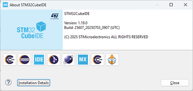

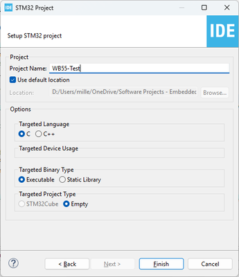

I'm not exactly sure what is happening, I upgraded to STM32CubeIDE v1.19.0 because when I created a new project, the .ioc file wasn't being created.  Checked the forum and read that upgrading STM32CubeIDE would fix the issue, which it did.  Today, I was going to create a new project so I could upload it here and now I'm back to not being able to create a .ioc file again.
Any insight?
Kindest regards
FilipKremen
this is known issue, please read this topic for instructions and let me know if you can continue with your project.

I have attached a new project that I created using the, from an existing .ioc file menu.  I tried upgrading to the WB firmware, 1.21.0 but for some reason it always downloads v1.17.3, no idea why it's doing that.  I uninstalled v1.17.3 prior to upgrading to v1.21.0.
Current version of STM32CubeIDE is v1.19.0.

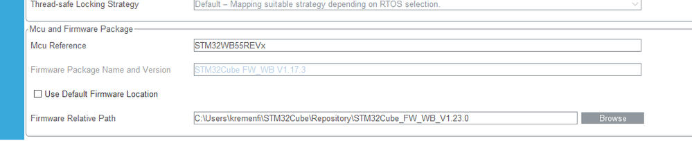

FilipKremen
can you please try to open the .ioc file in standalone STM32CubeMX and regenerate the project with version STM32Cube_FW_WB_V1.23.0? I have tried it this way and it worked on my side.
Thank you.
Best regards,
Filip Kremen

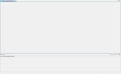

kumaichi
Using the latest version of STM32CubeMX to regenerate the project renders the .ioc useless in STM32CubeIDE.  When opening the .ioc in STM32CubeIDE, it shows the .ioc tab and that's it, nothing else is rendered.

kumaichi
In fact, after installing the latest version of STM32CubeMX, I can't load ANY .ioc files in STM32CubeIDE.  I had upgraded STM32CubeIDE via the STM32CubeIDE update process.  I then manually downloaded v1.19 and installed it.  Same thing, none of my .ioc files open now.
Any insight would be greatly appreciated.
