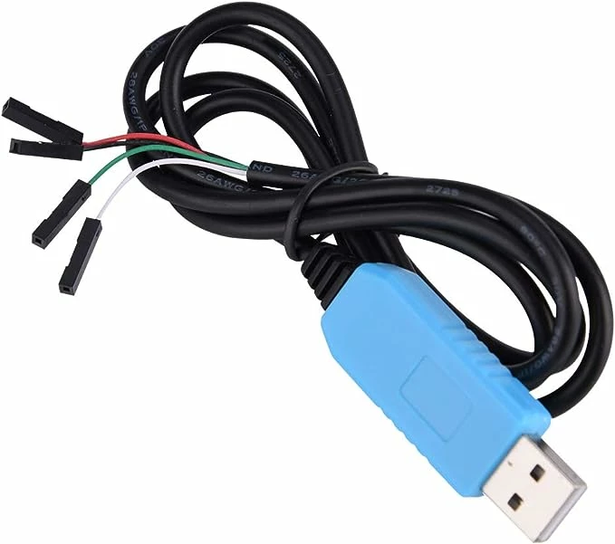

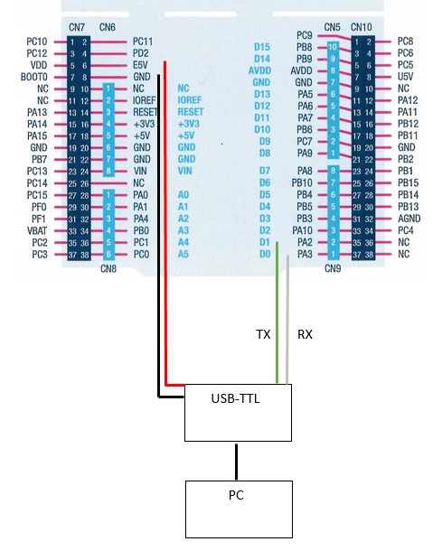

I am trying to use UART HAL with the stm32-f030r8 connected to the PC through a USB-TTL module.
The configuration is given below :
- The F030R8 has JP1 OFF, JP6 ON, JP5 on E5V.
- The USB-TTL is :
- The code is :

Then, the putty configuration is 9600 baud, 8 data bits, 1 stop bits, no parity; no flow control.
But I can't see anything in the terminal...
Would you please have suggestions ?
Thanks for your help ! :)

t is not clear from the schematic if the Rx and Tx labels are for the module or for connecting to an external UART. Maybe the signals are mixed up. But the second problem is the signal level. TTL is for 5V logic, but the MCU uses 3.3V logic. If the MCU pins are not 5V tolerant, the MCU can also be destroyed. I would recommend using a TTL-3.3V level converter.

The Rx and Tx labels are for the wire of the USB-TTL converter : Tx for the green one connected to PA2, Rx for the white one connected to PA3.

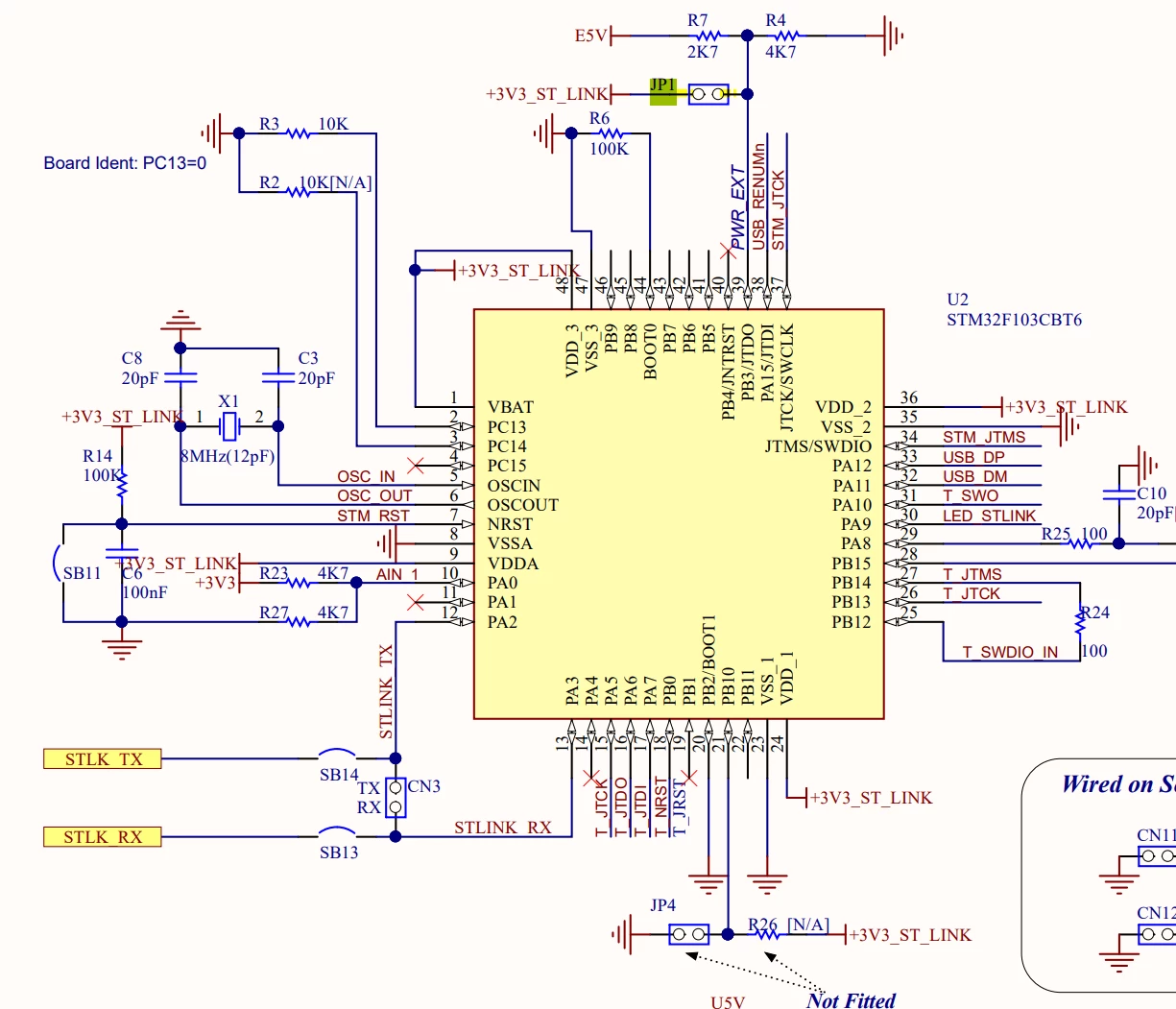

Hello @user-stm,
You may need to check the schematic of the board
MB1136-DEFAULT-C05 Board schematic
As you can see, some changes are needed to work with USART2. Otherwise, you can simply try different USART instance.
Hope this helps!

August 23, 2023
Hi again @user-stm,
you can disconnect SB13, SB14 and use CN3 to drive TX and RX pins of USART2.

Pavel A.
August 24, 2023
Remove the 5V wire between the dongle and the board. The dongle receives its power from USB.

Pavel A.
August 24, 2023
Disconnect the 5v wire (RED)  from the TTL module.

waclawek.jan
August 24, 2023
On Nucleo (and Disco/EVAL), always start with reading the manual and looking at schematics for jumpers/solder bridges (SBxx) settings.
But maybe instead of changing the SB settings, you might want to leave them for the PA2/PA3 being used through the on-board STLink's VCP; and if you want for some reason to use the additional external USB-UART connection, use different pins/UART.
Also, as others said, you have to cross-connect the cable, Rx to Tx and vice versa (unless the USB-UART converter's author mislabelled the wires).
