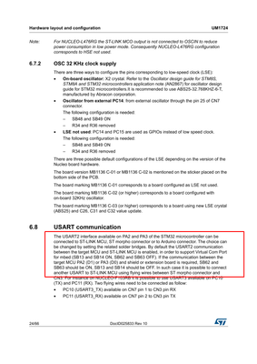

On Nucleo (and Disco/EVAL), always start with reading the manual and looking at schematics for jumpers/solder bridges (SBxx) settings.
But maybe instead of changing the SB settings, you might want to leave them for the PA2/PA3 being used through the on-board STLink's VCP; and if you want for some reason to use the additional external USB-UART connection, use different pins/UART.
Also, as others said, you have to cross-connect the cable, Rx to Tx and vice versa (unless the USB-UART converter's author mislabelled the wires).
