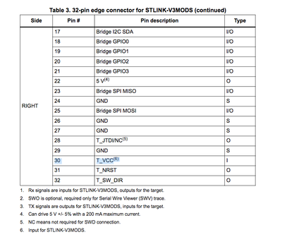

-> ST-LINK shows "Target voltage: 0.0 V"
The ST-LINK has a VTref pin (could be pin 1 of its connector), this should be connected to VDD.
Then the ST-LINK should show "Target voltage: 3.3 V"
Hello, my ST-LINK is the V3MODS version. Does it have a VTref pin? Also, it programs other development boards correctly.
Chris21
Senior III
Appears to be pin 30.
