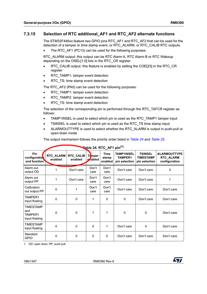

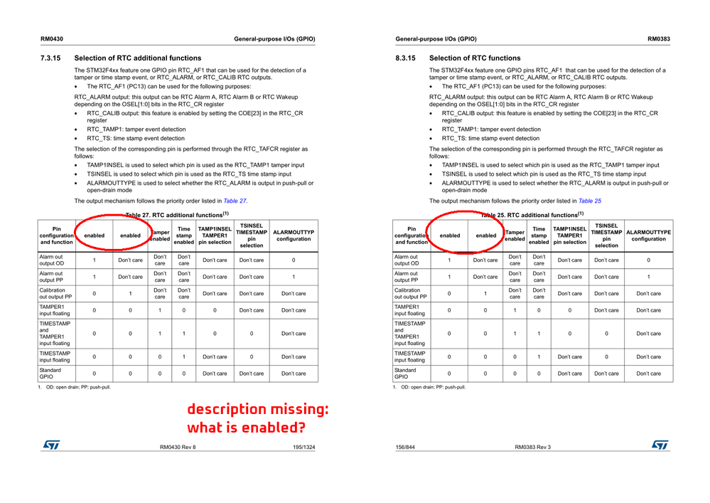

Typos in the RTC additional functions tables in some 'F4 RMs

Also at least for STMF0 and STMF4 (but maybe others), in RTC_ISR:
This register is write protected (except for RTC_ISR[13:8] bits).
Should be:
This register is write protected (except for RTC_ISR[15:8] bits).
‎2023-03-09 3:30 PM
That RTC_ISR thing is the same also for F7 and L4.
‎2023-03-10 2:32 AM
Wouldn't it be simpler to list the two bits which *are* write protected? :)
‎2023-03-11 2:33 AM
Also for L0 and L1.
‎2023-03-11 2:39 AM
RTC_ISR[15:8] (full byte) is not write protected.
