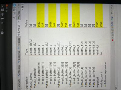

I sample a 1000Hz periodic signal twice  each period. At 50us after the start of the period for samples A and after 850us for samples B with a single ADC and a single channel. I trigger the ADC with a delayed PWM (Combined PWM1 on a G431) and the results go in a circular 32 values long DMA buffer and I get 16 A and 16 B samples alternated in it. Circular since I do not process the values constantly.
But the fact that A and B samples are alternating in one buffer doesn’t please me. Is there a way to get two DMA buffers out with A samples triggered by the rising edge of the timer and B on the falling edge (10us conversion times)?

Why not set the buffer as two dimensional array ?
(The DMA dont care about, how you call the members in the array.)
Then have A in one and B in other "one line" :
uint16_t   ADCdata[16][2] ;
A in [0..15][0] , B in [0..15][1] .

Interesting and hadn’t thought that that is possible of course. Makes coding easier. But still I want it to be super explicit that A’s are rising edge and B falling edge samples. I stop and start the PWM triggers now and then and do not want to risk adding two A’s or B’s and messing up the order for good. I can prevent that in code by resetting the DMA pointer but I see all of that as a risk. If I can do it in the peripherals that would be best imo.
You will not mess up anything, as long as you start the (circular) DMA - and never stop it.
If dont need data....just dont use them, but dont stop the running DMA process.
It will be correct until...ever or a strong spike destroys the cpu. :)
If you just stop the trigger, it will stay in this position and continue with next, when next trigger comes.
I see no problem here.
AScha.3, thanks, that helps me in my thinking of part of the problem. I will refrain from stopping DMA. And you are right: Stopping/stopping the PWM trigger doesn’t matter: rising and falling edges will always alternate perfectly. Hence the DMA will have A at the same edge as it initially started. OK, that issue is not an issue then. Learned something important (2D buffer and the consistency).
