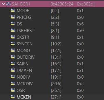

I am writing this because I am unable to enable the SAI on this development board. The strange thing is that I actually managed to enable it before and it was working correctly. However, while implementing another feature, I switched branches and worked on a different GitHub branch for some time. When I came back, I noticed that the SAI was no longer starting.
At first, I thought I had made a mistake in a commit, so I created a completely new project where the only goal was to start the SAI. Even though I believe all the steps are configured correctly, the MCK clock never starts, and the MCKEN register bit never becomes enabled. I am attaching screenshots of the SAI registers below.
As shown in the screenshot, the SAI is enabled, but I cannot see any clock output on the oscilloscope. As I mentioned before, what confuses me the most is that two weeks ago, using the exact same development board, I was able to make it work correctly.
I tried adding the following line inside the MX_SAI2_Init function
  hsai_BlockB2.Init.MckOutput              = SAI_MCK_OUTPUT_ENABLE;
After doing this, the MCKEN bit appeared as 0x01, but the SAI still did not start.

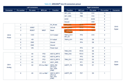

I am using the CN14 and CN15 headers of the development board.
When probing the pins with the oscilloscope, I observe the following:
  • D13 remains at 0V
  • D12 remains at 3.3V
  • D11 remains at 0V
  • D13 remains at 0V
  • D11 remains at 0V
Pin name D13, D12 and D11 are not related to SAI2.

About what you mentioned regarding the pins not being related to the SAI, they actually are, but it is not stated in the Discovery Kit manual. However, if you open the .ioc file, you will see that they are indeed connected to the SAI peripheral.
And regarding the SD_SAI pin, it is normal for everything to read as zeros if nothing is connected to the SD_SAI pin.

I changed the clock source from PLL3P to PLL1Q, and it started working correctly. I’m not sure why PLL3P does not work on my development board, but at least this workaround seems reliable. It also works with PLL2P.

I finally found the root cause of this issue! I am sharing the explanation here in case anyone else runs into the same trap when working with the split Boot/Application architecture on the STM32H7S/RS series.
The issue was not a hardware bug with the board or PLL3, but rather a firmware workflow oversight on my end regarding how the system clocks are initialized.
The Root Cause:
In this architecture, the physical hardware clock configuration —the SystemClock_Config() function— is executed inside the Boot project. The Appli (Application) project mainly relies on this pre-configured hardware state and simply calls SystemCoreClockUpdate() to update the software variables with the current clock speeds.
When I changed the SAI clock multiplexer to use PLL3 in STM32CubeMX, the initialization code to turn on and configure PLL3 was generated inside the Boot project. However, during my debugging, I was only recompiling and flashing the Appli project. Because the updated SystemClock_Config() was never flashed to the board, PLL3 was never physically turned on in the hardware.
The "Gotcha" that misled me:
What made this incredibly tricky to debug was that calling HAL_RCCEx_GetPeriphCLKFreq(RCC_PERIPHCLK_SAI2); in my Appli code actually returned the correct, expected frequency! I assumed this meant PLL3 was up and running.
Why did PLL1 and PLL2 work as a workaround?
Because PLL1 and PLL2 were already being initialized by the default Bootloader configuration (used for the main CPU clock, memory, etc.). So, routing the SAI to them worked out of the box.
The Solution:
If you make changes to the RCC / Clock Tree in CubeMX (like enabling PLL3 for an audio interface), you must regenerate the code for both projects, and critically, recompile and flash the Boot project before running your Application project. Once I did this, PLL3P worked perfectly for the SAI.
I hope this saves someone else a few hours of debugging!
