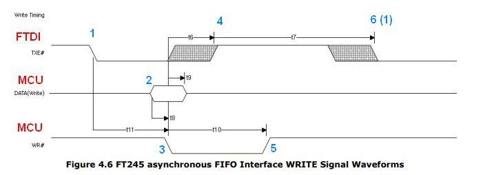

The communication protocol is simple (from FT2232H datasheet):
  • FTDI signals with TXE=0 that it is ready to receive 1 byte of data (1)
  • The MCU prepares the data for the bus (2) and generates a falling edge on WR (3)
  • At that moment, FTDI reads the byte of data and sets TXE=1 (4)
  • The MCU holds WR at 0 for at least another 30 ns (5), then returns WR=1 and waits until TXE is 0 again (6)

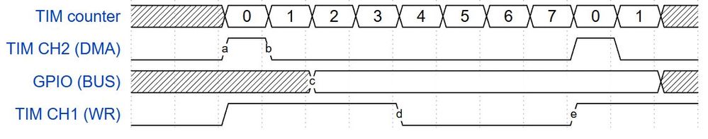

Core mechanism in STM32F446:
  • Transmit is managed by TIM1, DMA2 and GPIO
  • External signal (TXE line from FTDI => TIM1_ETR) gates TIM1 (low level enables counting) (a)
  • TIM1 runs in one-pulse mode with repetition counter 256 (respecite less)
  • TIM1 generates DMA requests from CH2 (as soon as posible after period start, therefore CCR2=1) (b)
  • DMA transfers (parallel) data from memory buffer to GPIO (it takes some time) (c)
  • TIM1 generates PWM on Channel 2 (WR line to FTDI). Falling edge means data write command to FTDI (d). The falling edge moment is selected so that the DMA has time to complete writing data to the GPIO (+ setup time elapsed).
  • If external signal (TXE) sets to H (FTDI signals that it is not ready to receive data), timer is paused (not gated). When TXE become L, timers continue in run (and transmit)
Once the timer completes the predetermined number of periods (repetition counter), it stops and triggers an interrupt
In the interrupt routine, the program determines how much data needs to be sent and sets the repetition counter accordingly and starts the next transfer (enable timer).
Since the timer always sends a predetermined and selectable amount of data (period, DMA requests), there is no risk that the application will lose track of the amount of data sent. For example, when sending 520 bytes of data, 520 is set in the DMA->NDTR, the first burst will have RTR="256", the second also RTR="256", and the third RTR="8".
The transfer takes place in "bursts" determined by the RTR value of the timer. Typically, the largest possible RTR is selected if there is a lot of data. However, RTR is limited to 256 on older chips, while newer chips allow for higher values.

void TIM1_UP_TIM10_IRQHandler(void){
	LL_TIM_ClearFlag_UPDATE(TIM1);
	LL_GPIO_SetOutputPin(GPIOB, LL_GPIO_PIN_7); // debug indication
	// prepare "new" burst
	// if number of remaining data in buffer > burst size -> then perform "full size" burst
	if(datacounter > 256){
		LL_TIM_SetRepetitionCounter(TIM1, 255); // set burst size (Repetition counter) - thats probably not neccesary (should be already set)
		LL_TIM_EnableCounter(TIM1); // start another burst
		datacounter = datacounter - 256; // decrement downcounter (number of bytes to transfer)
	} // nothing to transfer - done
	else if(datacounter == 0){ // if there is no data to transfer -> transfer is over
		transfer_stop();
	else{ // "partial burst" (last one)
		LL_TIM_SetRepetitionCounter(TIM1, datacounter); // set burst size (Repetition counter)
		datacounter=0; // clear downcounter - thats last data of transfer
	LL_GPIO_ResetOutputPin(GPIOB, LL_GPIO_PIN_7); // for debug/monitoring purposes
// start data transfer (indication in transfer_status)
char transfer_start(void){
	uint16_t transfer_size=4096; // copy total transfer size (now it is fixed, can be function parameter)
	datacounter = transfer_size; // copy "bytes to send" to downcounter
	// check if buffer is greater then burst size
	if(datacounter > 256){ // next burst is "full size"
		datacounter = datacounter - 256; // remaining bytes to send
	}else if(datacounter>0){ // next burst i "partial size"
		datacounter = 0; // last data to send
	}else{ // that shouldnt happen (who wants to transfer 0 bytes ?)
		return 1;
	// set DMA
	LL_DMA_SetMemoryAddress(DMA2, LL_DMA_STREAM_2, (uint32_t)buf); // set buffer address (now fixed, can be function parameter)
	LL_DMA_SetDataLength(DMA2, LL_DMA_STREAM_2, transfer_size); // set total number of bytes to transfer
	// for safety, clear and update counter registers
	LL_TIM_SetCounter(TIM1, 0);
	LL_TIM_DisableIT_UPDATE(TIM1);
	LL_TIM_GenerateEvent_UPDATE(TIM1);
	WRITE_REG(TIM1->SR, ~(TIM_SR_CC1IF | TIM_SR_CC2IF | TIM_SR_UIF));
	LL_TIM_EnableIT_UPDATE(TIM1);
 // running transfer indication
	transfer_status=1;
	// enable transfer
 LL_TIM_EnableDMAReq_CC2(TIM1);
 LL_DMA_ClearFlag_HT2(DMA2); // all flags must be cleared to enable DMA (!!!)
 LL_DMA_ClearFlag_TC2(DMA2); // i am clearing only two of them - :/
 LL_DMA_EnableStream(DMA2, LL_DMA_STREAM_2);
 LL_TIM_EnableCounter(TIM1); // from now, transfer is running
 return 0;
// stop transfer (called when all bytes are out)
void transfer_stop(void){
	LL_DMA_DisableStream(DMA2, LL_DMA_STREAM_2);
	LL_TIM_DisableDMAReq_CC2(TIM1);
	LL_TIM_DisableCounter(TIM1);
	transfer_status=0;
Of course, I appreciate all comments, especially if I have overlooked any critical issues, etc.
Best regards,
Michal Dudka
5 REPLIES 5
