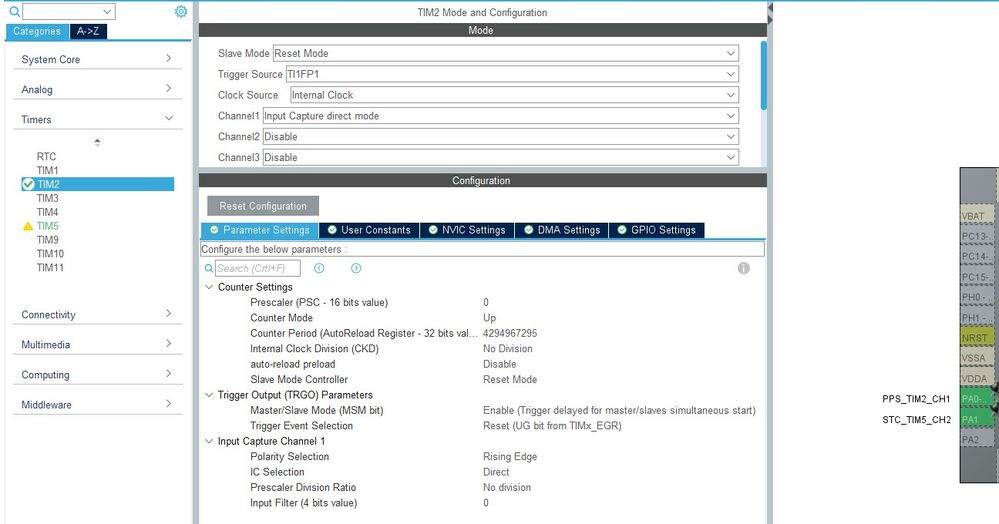

To measure the external pulse width, which is the best mode in stm32F411 - Gated Mode Timer or Input Capture Mode.
mahapushpa
I need to calibrate the internal timer to do ADC sampling using GPS receiver.
The accuracy of measurement is most important (zero or minimum jitter), PPS output of GPS receiver is input.
Thanks in advance

I don't quite see, how would you use the Gated mode for this purpose.
There's no problem with input capture, though.
PWM Input Capture with CH1/CH2 measuring period/duty

I tried to use slave with gated mode but did not able to generate falling edge event/interrupt of input (PPS from GPS) at TIM2-CH1 (PA0, 32 bits timer). So finally, I have gone with Input Capture direct mode with slave Reset, trigger source with TI1FP1 as attached picture.

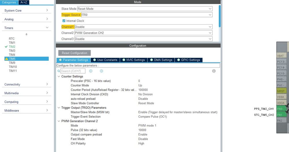

ADC start pulse is PWM out in mode 1 from TIM5-CH2 (being nearby pin, PA1), slave with Reset Mode, Trigger source ITR0. I able to get results as expected, sync with gps's pps pulse rising edge, measurement of pps width in 32 bits accuracy with 100 MHz, adjustment of adc sampling rate based on measurement of pps pulse, pulse free running as well when PPS is not available due to some weather or failures. Being used two timers, it give more flexiblity to control the prescaler without effecting each other. The Gated mode must be much simpler than this, but do to configuration issue of event/isr for falling edge, I ignored it. I do not want to use more IOs also.
Thanks to all who provided input to find solution. Still suggestions are welcome to improve further, my objective is minimum IO, processing and disturbances to CPU.

Reset has a lag (delay) after the Input Capture. This is not documented by ST, but found by experimentation to be 2 cycles on some STM32 (e.g. https://community.st.com/s/feed/0D50X00009XkW1oSAF - unofrtunately, Clive's initial post got lost in the forum migration back then).
You may either account for this lag by adding a constant to the measured period, or, maybe better, simply don't use the Reset in Slave-mode controller, just subtract two consecutive captured values from each other.

  4. Do you know any impact of using TIM5-CH2 as PWM out using ITR0 as trigger source to align with ICP input or any better method to this? This alignment is also very crucial for synchronization.
