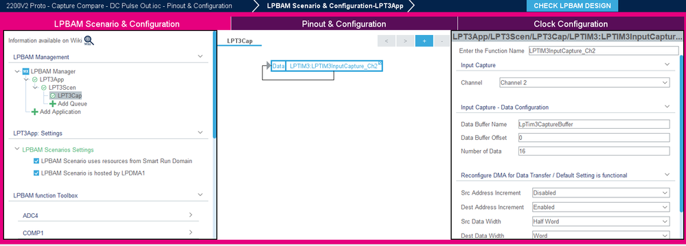

LPDMA1 CH0 is enabled in the non-LPBAM IOC configuration editor in Linked-list and circular mode.

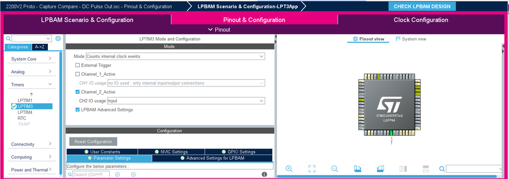

I've created an LPBAM application/scenario with just one queue, and LPTIM3 channel2 set for input capture clocked by external clock (LSE crystal 32.768KHz).
(ScreenShots below)
This passes 'CHECK LPBAM DESIGN' in the editor, and generates code without errors.

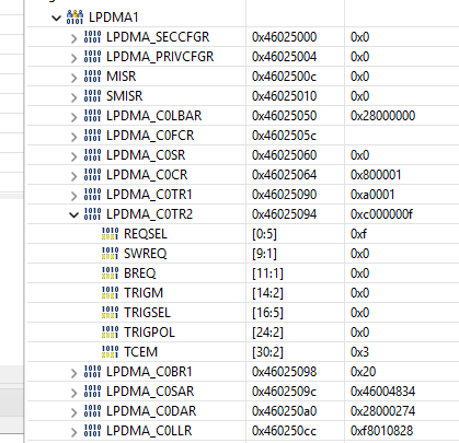

I can see this in the debugger: the destination buffer for the captures just doesn't seem to get written to, If I set a brakpoint within the loop, the LPDMA1 registers just don't change, although they look correctly set in terms of addresses and peripheral selection:
LPDMA_C0CTR2.REQSEL = 0xf (15) which is correct for LPTIM3 (lptim3_ic2_dma)
LPDMA_C0SAR = 0x46004834 (the address of LPTIM3 CCR2 register)
LPDMA_C0DAR = 0x28000274 (start of the buffer

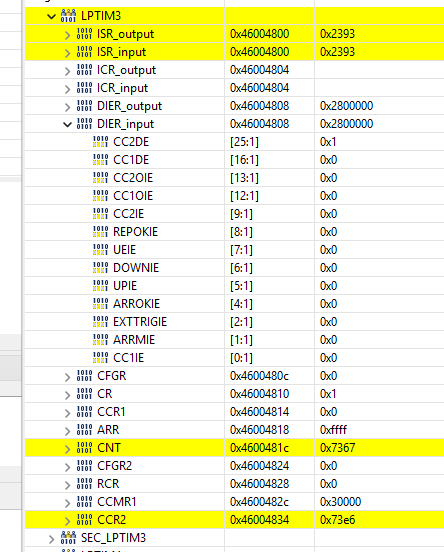

LPTIM3 registers:
DIER_input.CC2DE = 0x1 (Capture/compare 2 DMA request enable)

LPTIM3 count and capture registers are changing between repeated run/break sequences, so I'm pretty sure it is running and capturing, just no DMA trigger.
Does anyone know or can see what might be wrong? I've included screenshots below of the config pages and debugger register dumps.
