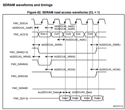

2. On page 306, it is stated, "The FMC SDRAM controller features a Cacheable read FIFO (6 lines x 32 bits). It is used to store data read in advance DURING the CAS latency period and the RPIPE delay ..." I'm confused as to how data is read DURING the CAS latency period. Wouldn't the data from the SDRAM be available to read only AFTER the CAS latency period?

The interest of the RPIPE delay is to add few cycles before sampling the data while configuring correctly the CAS latency.
When inserting the RPIPE delay, since the is read FIFO fetching data during the CAS latency cycles, adding RPIPE delay will add other cycles and allows to fetch more data in Read FIFO. We provided the formula of number of anticipated data based on the RPIPE and CAS latency configuration.

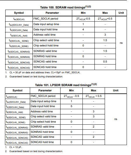

For SDRAM read timing, I recommend you referring to DS10693 Rev 10 Table 100. SDRAM read timings and Table 101. LPSDR SDRAM read timings.
