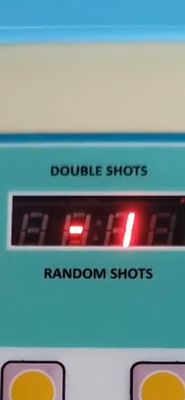

I’m using the STM32L443 in one of my products, and currently, there are around 2,500 units deployed in the field. I’ve been experiencing issues that I believe are related to the firmware programming process during production.
The product includes a seven-segment LCD. After programming the firmware and running tests, I noticed that some characters do not display correctly in certain menu screens. I’m confident this is not a hardware issue. Interestingly, when I reflash the firmware on the same board, everything starts working properly — the display shows the correct characters.
These are just the visible symptoms. I’ve also observed cases where the firmware seems to get stuck in a specific scenario. For example, there’s a routine that runs every 5 minutes. On the third iteration, the system hangs. Even after a power cycle, it always gets stuck at the same point. However, if I reflash the firmware, the issue disappears.
This makes me suspect that the firmware might not be properly programmed during the initial flashing in production. I’m using STM32CubeProgrammer with an ST-Link V2 to load the firmware, and I have the verify options enabled. After flashing, I also lock the code (read-out protection).
That said, I’m now unsure whether the firmware was correctly programmed on all units during production.

The reflashing is almost certainly a coincidence - far more likely a subtle bug - or bugs - in the code.
@oguzhansenol wrote:
For example, there’s a routine that runs every 5 minutes. On the third iteration, the system hangs. Even after a power cycle, it always gets stuck at the same point. .
So have you tried attaching the debugger in this state to see where it's stuck?
https://community.st.com/t5/stm32-mcus-embedded-software/processor-stuck-if-i-run-code-without-debugger/m-p/802267/highlight/true#M63401
Add instrumentation to your code so that you can see what's happening; eg, UART output.
Be sure that any error handlers - eg, Hard Fault Handler - give a clear indication when they're hit, and make diagnostic info available.
Have you checked the interface with an oscilloscope and/or logic analyser?
Is there noise?
Are the levels correct?
Is the timing correct?
etc ... ?

Move to latest version and make sure you do flash ALL the memory, not just the code.
Shouldn't we see that the code is stuck somewhere in the code and all of them? Additionally, as I mentioned, I can see that some characters on the LCD aren't working. I even log the number of times the device has been activated. Deleting everything and reinstalling it fixes it, and the device that doesn't work displays a 0. Sometimes, when we reinstall it, it displays a -1.
That's why I said a subtle bug!
Could be multiple (subtle) bugs, so the symptoms only manifest when they all happen to align...
the LCD ... displays a -1.
That looks more like LEDs ?
How, exactly, do you do that?
