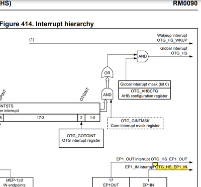

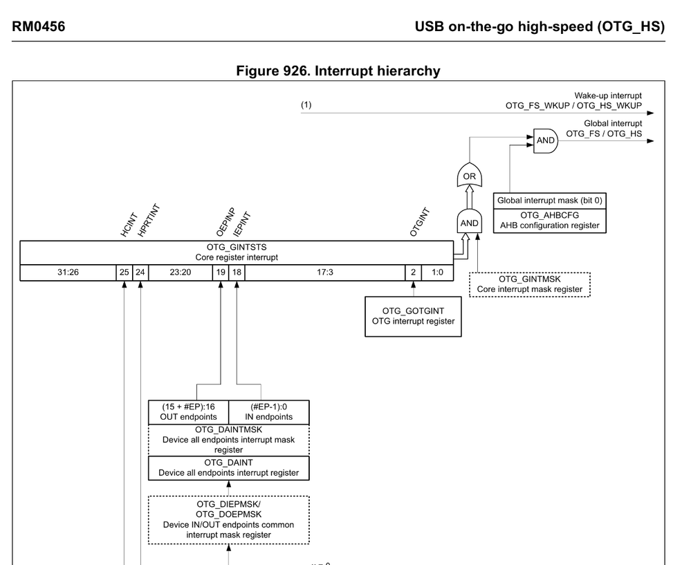

Thank you for the insight FBL.
However I checked the RM0456, which is referred to the STM32U5 series MCUs and it shows the the OTG_FS_WKUP / OTG_HS_WKUP line. Screenshot_20250618_112544.png

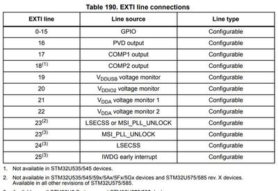

Hi @j_filipe
In footnote, it is noted:
1. OTG_FS_WKUP becomes active (high state) when resume condition occurs during L1 SLEEP or L2 SUSPEND states.
This is not direct EXTI wakeup.
You can refer also to Table 190: EXTI line connections: we don't have direct USB wakeup over EXTI on STM32U5.
You have 40ms to detect vbus cable loss.
With aggressive low power mode, we can poll SESSVLD in OTG_GCCFG for about 40 ms every 25us to monitor vbus state. There should be no event generated.
Best regards,
