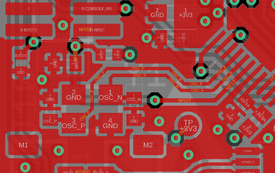

3. Your PCB layout does not follow many of the recommended practices set out in AN2867.
In particular, your have not used a GND guard ring, and the traces from the MCU to the oscillator look longer than they need to be (the appnote includes an example gerber).

Of course I can't be sure what the issue actually is (If I knew, I'd tell you. honest). But You have the chip at 45deg yet kept the crystal at 90. That pushes the crystal away from the chip.

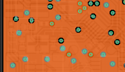

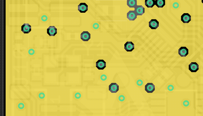

Compare the trace length in your example
vs. the recommended layout
There's barely any trace between the chip/osc footprints there, while your layout has like a small runway. That could be significant. On the very next page, the appnote shows an example of a bad layout, and calls out the traces as too long - for a layout with about half the trace length you used.

X1 in your example layout from AN2867 is the LSE 32.768kHz crystal, I'm using the HSE crystal pins, which would be the X2 traces. My traces are 11.3 & 14.3mm long, which is 1/28,000 of the 8MHz wavelength so reflections shouldn't be an issue and it's reasonably well shielded and treated as a diff pair so noise should be pretty minimal. Basically I find it hard to see that the layout could be the problem. Especially considering what was in the original design.
Originally (and working in ~350 boards) the crystal was this one here. with the following layout
It's a bit hard to see but the traces are 14.0mm and 28.2mm long. The crystal has a Cload of 18pF, Cshunt 7pF, ESR of 60Ω and has 30pF external load caps. The fact this has been extremely reliable despite almost deliberately breaking every single guidance in AN2867 means I'm very suspicious of claims that having layout exactly like AN2867 matters.

What stands out to me at first glance is the unsuitable layout. @BarryWhit has already inserted the correct excerpts from AN2867, but there is much more to read (between the lines) in AN2867. I have mentioned it several times here in the community (e.g., here, there, and another one), and maybe we should create a Knowledge Base article about it: it is important not to have traces under the crystal, and the crystal should be surrounded by separate GND - underneath and around it, which in turn should be connected to the GND pin of the STM32 in the shortest possible way. This is nicely shown as a white area in the inserted layout example of the AN2867, where the GND around and under the crystal is separated from the rest of the GND.
In the layout of @RobertK, there is a large, continuous GND plane where all sorts of currents can pulse along and disturb the crystal.
