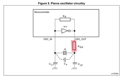

The screenshot in OP shows a Rigol DS1104 ZPlus 100Mhz Scope.The standard probe that comes with this scope is the RIGOL pvp3150 passive probe. Its input capacitance is 10pf +/-5pF. Compared to the load capacitor values used, that's far too much to treat the screenshot shown in the OP as reliable.
I suggested that the oscillation be measured monitored via the MCO pin, but unfortunately this never happened. It would also have been interesting to zoom into the waveform to see if the oscillation itself is distorted, as this might have given us an additional hint.
The new crystal used is specified with a typical drive level of 10-50uV. The original crystal is specified as 50uV typical, and 300uV max. It's at least possible that old crystal was more tolerant of a higher drive level (it was also physically much larger). According to this Crystal Vendor's page on choosing STM32 crytsals:
Overdriving is an issue for the stability of the oscillations and is manifested in no oscillation or high jitter. Equally we need to consider drive through the crystal. The spec will detail the max drive level, and testing should be done to see these criteria are not exceeded.
and too high a drive level can also damage the crystal.
The drive level is proportional to crystal ESR, so a lower ESR crystal also lowers the drive level which
may also be another factor (beyond increased gain margin, which was ample to begin with) why a lower
ESR crystal works better.
it would have been interesting to try and follow AN2867 to see if adding a limiting resistor Rext would
have fixed the issue.
