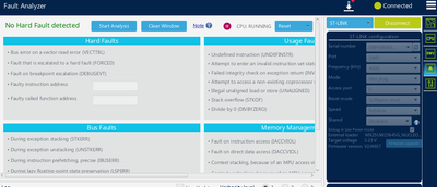

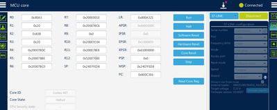

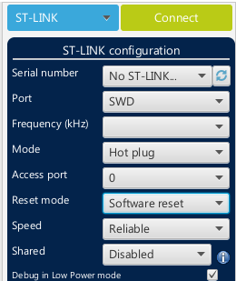

2. besides the tips you got....you can connect in CubeProgrammer to the "stuck" cpu without reset:
..in hot plug mode. Just to see: where it is and is it still running/working;
so you can come closer to find out: hardware spike puzzling the core or just hanging in an INT.
here on H743:
RUN lets it just run on - where it was executing....whatever. :)
And checking for hard fault:
