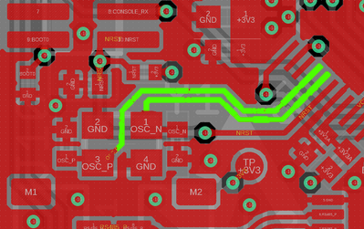

Hi all, I have a problem with a new version of an existing PCB using the STM32F334C8T6 microcontroller.
Known working code is loaded onto the new PCB, power is applied and the MCU starts up the clock and then seems to sit idle. If the NRST pin is then driven low and released the MCU starts up and begins operating normally. Holding NRST low on power up and then releasing it after a duration does not work, the MCU must attempt to start up and fail first. NRST is connected to a 10kΩ to +3V3 and a 100nF to 0V. BOOT0 is connected to a 10kΩ to 0V.

I've gone through a couple of stages of being suspicious of the clock as it gets enabled by the code, but then the code seems to stop/stall. However the scope traces don't show any significant problems. I've also compared the clock signal after the reset with the MCU running code and it looks identical to the above scope trace where the MCU is stalled.
The new PCB does have a different 8.000MHz crystal so I may have got the load capacitors wrong. The new board is using this crystal from JLC with 2x 22pF 0402 C0G load capacitors. Is this correct? Should I be using a different value?
There are other minor differences between the two boards, but nothing that would suggest this issue. e.g. some pins no longer have a 1kΩ resistor linking them even though one pin was never enabled/driven in the code.
I'm running out of hair to tear out so welcome any suggestions of what the issue might be or further debugging steps. Thanks!

I have no idea why this is happening. Just a few things I notice:
1. I second admonition from above, that you should not probe your crystal, those are high impedance and the additional capacitance from the probe will disrupt operation (at the very least, you can't rely on the frequency you measure). You can use the "Master Clock output" feature of the RCC to route a clock out to a pin for probing. That should not affect the operation of the Crystal circuit itself.
2. The nRST RC circuit you described, has a time constant which means that the overall transition lasts around 3ms. Now, some datasheets (out there in the world) usually tell you to assert reset for some period of time (which can last ms), but none of them want you to feed such a slow transition to the input. I haven't checked if the nRST has a schmitt-trigger input, but in some parallel-universe, your MCU may not like this.

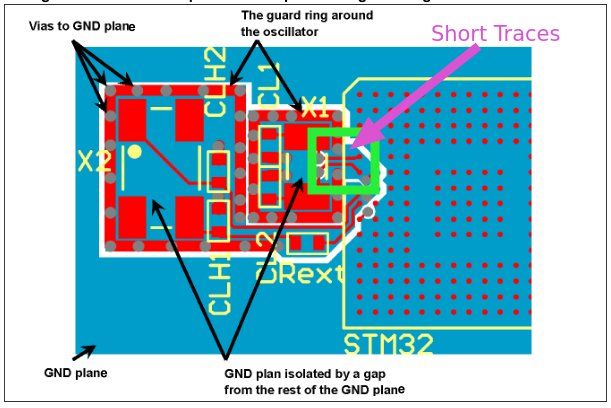

3. Your PCB layout does not follow many of the recommended practices set out in AN2867.
In particular, your have not used a GND guard ring, and the traces from the MCU to the oscillator look longer than they need to be (the appnote includes an example gerber).
4. The layout issues may be exacerbated if you are you near any source of EMI? fluorescent lights? old test equipment? Try another room away from equipment. If anyone on your team has a magnetic personality, send them out to pick-up lunch. Try turning off the lights (Just a shot in the dark, lilz).
I have no idea if any of this would solve your problem. But do let us know what you find. Don't despair, but keep at it, you'll figure it out eventually.
Update: another thing to try is to butcher one of your boards and jerry-rig an external clock source for the MCU from a frequency generator if you have one. Then configure your RCC to use "HSE. Bypass" mode. Assuming you haven't introduced a new problem doing this, If your problem disappears you then pretty much definitely isolated the issue to your crystal circuit. If not, you may have ruled it out as the source of the problem.

I don't have a complete guard ring
I don't see a guard ring, all I see is a ground pour that apperently covers the entire layer. How important that is, I can't tell you.
I have yet to see a single board meet all of the 'recommended' practices of AN2867.
Of course I can't be sure what the issue actually is (If I knew, I'd tell you. honest). But You have the chip at 45deg yet kept the crystal at 90. That pushes the crystal away from the chip.
Compare the trace length in your example
vs. the recommended layout
There's barely any trace between the chip/osc footprints there, while your layout has like a small runway. That could be significant. On the very next page, the appnote shows an example of a bad layout, and calls out the traces as too long - for a layout with about half the trace length you used.

X1 in your example layout from AN2867 is the LSE 32.768kHz crystal, I'm using the HSE crystal pins, which would be the X2 traces. My traces are 11.3 & 14.3mm long, which is 1/28,000 of the 8MHz wavelength so reflections shouldn't be an issue and it's reasonably well shielded and treated as a diff pair so noise should be pretty minimal. Basically I find it hard to see that the layout could be the problem. Especially considering what was in the original design.
Originally (and working in ~350 boards) the crystal was this one here. with the following layout
It's a bit hard to see but the traces are 14.0mm and 28.2mm long. The crystal has a Cload of 18pF, Cshunt 7pF, ESR of 60Ω and has 30pF external load caps. The fact this has been extremely reliable despite almost deliberately breaking every single guidance in AN2867 means I'm very suspicious of claims that having layout exactly like AN2867 matters.
